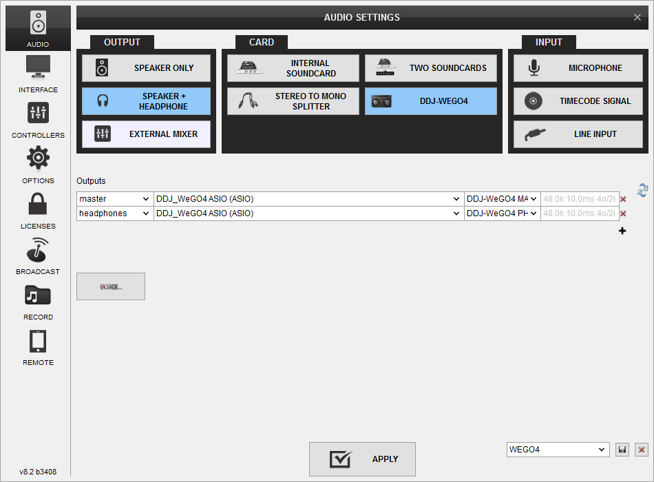

A detection window will appear next, asking to use or not the pre-defined audio setup with the built-in sound card of the DDJ-WeGO4 Click on the "Use Soundcard" if your speakers are connected to the Master Output of the DDJ-WeGO4.
You can still make changes in the Audio setup from VirtualDJ Settings->AUDIO tab.
Click to OK.

AUDIO Setup
The unit has a pre-defined Audio setup and a special button in the AUDIO tab of Config to provide that. Alternative Audio setups can be applied in the same window.
