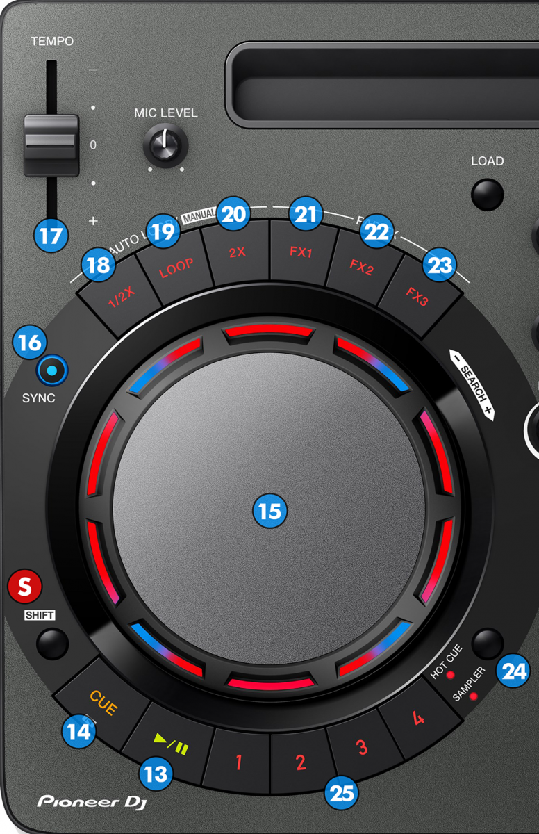

Decks
  1. PLAY: Plays-Pauses the track.
  2. Cue : If the track is playing, pauses and goes to the last Cue point. If the track is paused, sets the current position as Cue point, and previews the Cue as long as the button is pressed.
    If SHIFT is pressed, it jumps to the beginning of the track.
  3. JOG: Touch sensitive platter for scratching, bending, and seeking through the song.
    Use the touch (top) area of the Jog to Scratch the track and the outer part to bend (temporary speed up/down). The Jog can operate also only in Bend mode if the VINYL mode is disabled from the VirtualDJ GUI.
    Hold SHIFT down and then use the Jog to fast search through the track.
  4. SYNC: Syncs the deck with the opposite Deck (will match BPM value and Beatgrid if tracks are playing).
    Hold SHIFT down and then use this button to beat tap (manually set the tempo of the track if calculated incorrectly by VirtualDJ)
  5. PITCH: Adjusts the tempo of the track. A different pitch range can be selected from the VirtualDJ GUI.
  6. Loop HALF. Use this button to half the size of the Loop in beats.
  7. Loop . Use this button to trigger the selected Loop and use the same button to exit.
    Hold SHIFT down and then use this button to create a manual Loop . On first press, a Loop In (Entry) point will be set and the Loop IN button of the GUI will be lit. On 2nd press, a Loop Out (Exit) point will be set and the manual Loop will be enabled. Press this button again (3rd time) to exit the Loop .
  8. Loop DOUBLE. Use this button to double the size of the Loop in beats.
  9. FX1: Press this button to activate momentarily the selected effect of slot 1. Hold SHIFT and then press this button to select the next available Effect from the list for Effect slot 1.
  10. FX2: Press this button to activate momentarily the selected effect of slot 2. Hold SHIFT and then press this button to select the next available Effect from the list for Effect slot 2
  11. FX3: Press this button to activate momentarily the selected effect of slot 3. Hold SHIFT and then press this button to select the next available Effect from the list for Effect slot 3
  12. SAMPLER MODE. Use this button to toggle between the Sampler and the HotCue mode for the HotCue/Sampler buttons (25).
  13. HOTCUE/SAMPLES (1-4). The 4 numbered buttons offer different functionality depending on the selected mode (24).
    In HotCue mode, each one of the 4 buttons assigns Hot Cue Point (1 to 4) or returns the track to that Hot Cue Point if the HotCue is assigned.
    When a Hot Cue Button is unlit, you can assign a Hot Cue Point by pressing it at the desired point in your track.
    Hold SHIFT down and then press a button to delete its assigned Hot Cue Point.
    In Sampler mode, each one of the 4 buttons triggers a Sample from the selected Sampler Bank of VirtualDJ. If the selected bank has less than 5 samples, both sides of the DDJ-WeGO4 will control the same samples. If the selected Sampler bank has more than 4 samples, the left side of the DDJ-WeGO4 will control samples 1 to 4 and the right side will control samples 5 to 8.
    The trigger/playing behavior depends on the selected Trigger mode of the Bank (On/Off, Hold, Stutter or Unmute) and can be changed from the VirtualDJ Browser in the Sampler view of the Side View.
    Hold SHIFT down and then use the same buttons to play-stutter the sample.
