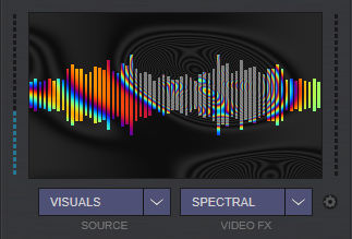

I like the update to spectral too!

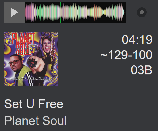

Browser Info tab shows fluid bpm
Actually in the latest early access release.
Can someone explain please? 🙏🏾

9295 now in Early Access with three changes for fluid:
-The browser info tab shows fluid bpm:
It will show the ~ in front of the bpm just like in the browser to indicate that it's fluid, and if there are big variations, it will also show the minimum and maximum bpm throughout the track.
It also orders the bpm's shown, so if the low bpm is closer near the end of the track it will be shown last
-The bpm shown on the deck is now more precise for stable but small changes.
Drummer fluctuations are still averaged out as before, but if the bpm is consistently increasing/decreasing, this will be better reflected on the deck.
This does require to re-analyze the track though.
-The bpm editor will show x2 and /2 buttons in fluid mode as well when the track has a fairly consistent bpm. (If there's different areas with completely different bpm they still won't be shown, since it won't be clear which area you meant to change)
For most corrections this should be easier than having to change the detection range all the time

@Adion I would say that wide BPM change info showing the max and minimum BPM throughout is valuable in the BPM column for the browser too (what I had described/suggested way back on the Request Feature post) - if it isn't too much effort, could it be done if the column is widened enough? I honestly almost never have the File Info panel open - my focus is always in the browser track listing display to determine a track to play.

Agreed. In the browser and even on the decks would be useful (although probably involving skin mods). The more feedback we have on what the BPMs are doing, the better.
geposted Sun 12 Apr 26 @ 1:13 pm
Probably having something like
bpm_rangein the browser would be good. That way it can be used in skin too and doesn’t modify the existing bpm field for those who are used to that.
geposted Sun 12 Apr 26 @ 1:53 pm
Yes in the browser list and in the deck info too please ✌🏾✨️🙏🏾
