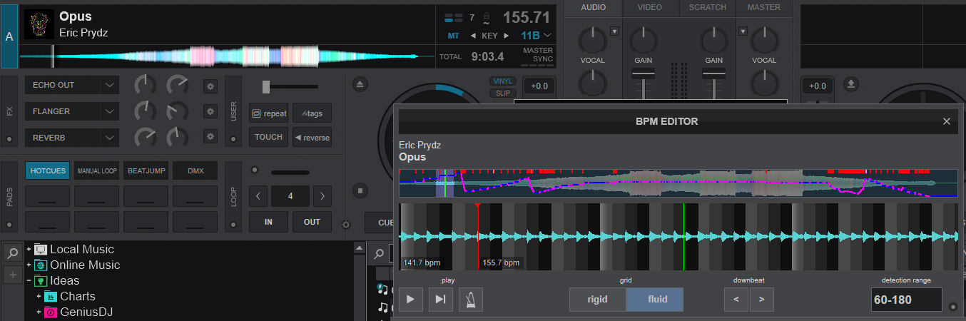

groovindj wrote :
I've not seen them displayed elsewhere - even in the editor, many tracks now just show one anchor, one BPM and a straight blue line. Yes there are sometimes red areas, but even if you zoom in on those areas, it doesn't always show you a BPM value there.
I see what you mean (I just loaded Jimmy Cliff - The Harder They Come and saw there are red areas with no marker), but doesn't that mean the BPM change isn't significant enough to require a marker/actual BPM display change?
It seems like if the BPM change is significant enough (tolerance value unknown), it will display a change (other areas of the song do display the change in the deck info area for me). I would say another explicit setting for that would solve the problem but I wonder if that does more harm than good for the average user.

With fluid, if the BPM difference is big enough, you'll get the BPM values displayed as before. Therefore you can anticipate the different BPM. If the BPM difference is sublte, you still get the tidle "warning"
So you know it's "about" that much BPM, and that the software will handle the variations upon mixing.
If I were you and I absolutely wanted to keep that +/-5 BPM rule, whenever I used a fluid track I would change my tolerance to +/-3 BPM just to be "safe" that I would not hit the +/-5 BPM mark during a transition.

Quote :
Min/Max BPM doesn't guarantee that min BPM is on the beginning and max at the end
....which is why I think a real time BPM readout is important!
It's great if you know the tracks, but we can't know everything, and sometimes it's fun to play things you're not familiar with.
We're not always going to know the structure of the song, so having a live BPM readout (and being able to see the actual BPM figures through the track) is helpful.
Take the previously mentioned EWF example - VDJ makes it look as if (after the slower intro) it has a steady fixed tempo of 126.0 until the end of the track, but that's just not the case. VDJ is giving us false information. If you cued up a track at 126 to mix in near the end, it would be 3 BPM too slow.

I'm quite happy with the fluid analysis, but I wanted to report a terrible result with "Opus / Eric Prydz" track:
I tried to narrow the analysis to 100-140 BPM range, but it wasn't better.
How should I deal with such a track?
geposted Tue 07 Apr 26 @ 9:40 pm

@JeromeIP I think you found the best (worst?) possible track to challenge the system LOL 🤣
IMO that's not the sort of track that would be mixed into or out of anyway - at least not the ambient sections.
The centre part is what would be played for the dance floor.
It does seem that the system really struggles to understand things when there's no beat.
geposted Tue 07 Apr 26 @ 10:13 pm
