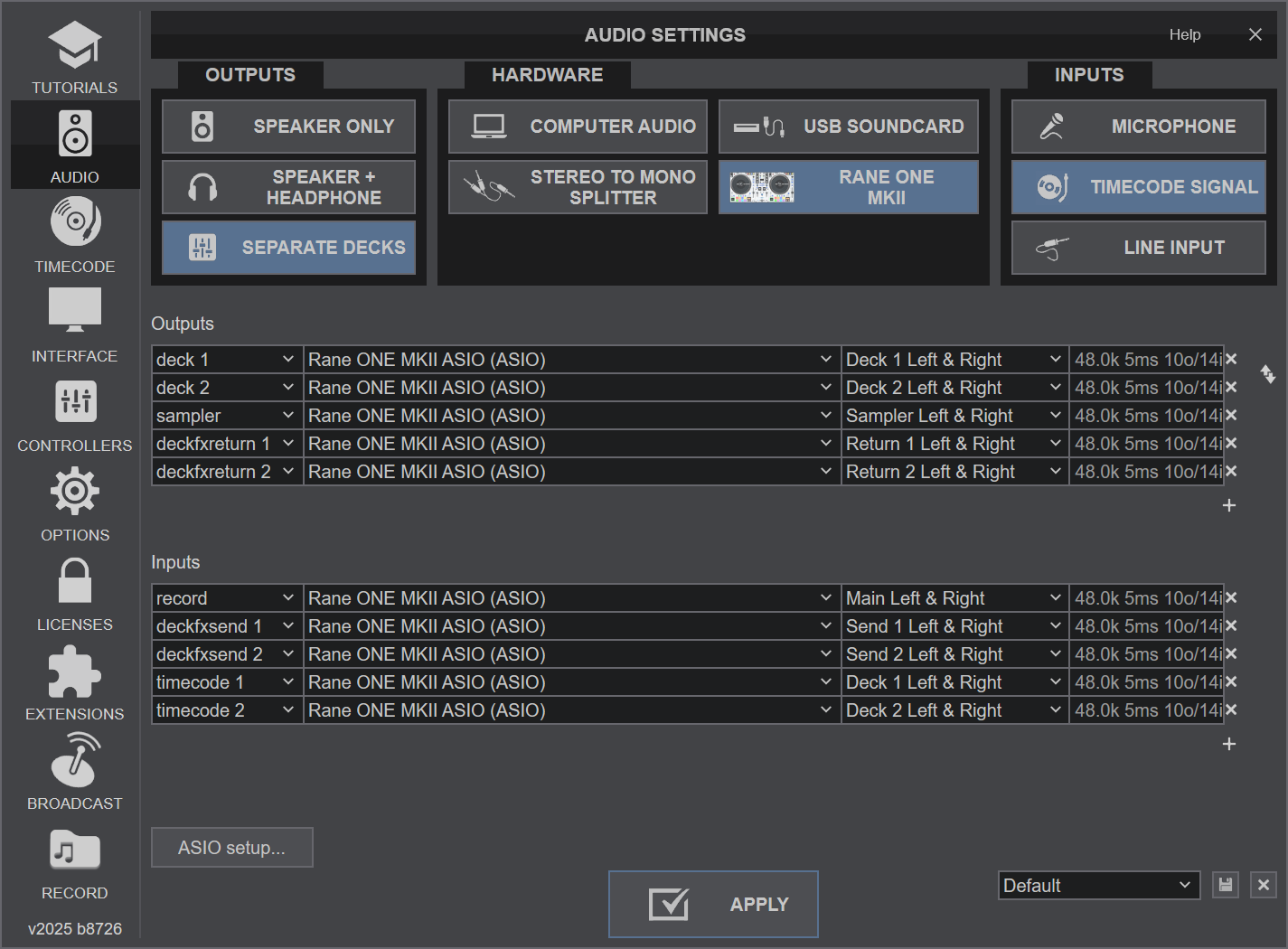

Timecode (DVS)
VirtualDJ is offering DVS (Digital Vinyl System) support for the Rane One MKII. A Timecode Plus or Pro Infinity license is required. 2 Timecode Inputs are available to control any software decks via Timecode CDs or Vinyls.
Both Mixer Channels can accept LINE ( Timecode CDs) or PHONO Sources ( Timecode Vinyls) depending on the CD/PH switchers at the rear panel of the unit.
- Connect your Timecode devices at the rear panel of the Rane One MKII
- Open VirtualDJ configuration window and select the AUDIO tab on the left
- Click on the "TIMECODE SIGNAL" button to enable the Timecode inputs
- Your sound setup should be like the one shown on the following image:
Rane One MKII Audio Configuration with Timecode Inputs Configured - Click on "Apply" button
- Click on the Timecode icon on the left side of configuration window.
- Press PLAY on your Timecode CD or Vinyl device and VirtualDJ will automatically detect your Timecode type and make the appropriate adjustments for best performance.
- Click on the ON buttons from the Timecode panels of the Default Skin to enable the Timecode control to any Deck.
- Press the CALIBRATE button if for any reason the signal is not detected (possibly due to reversed phase connections).

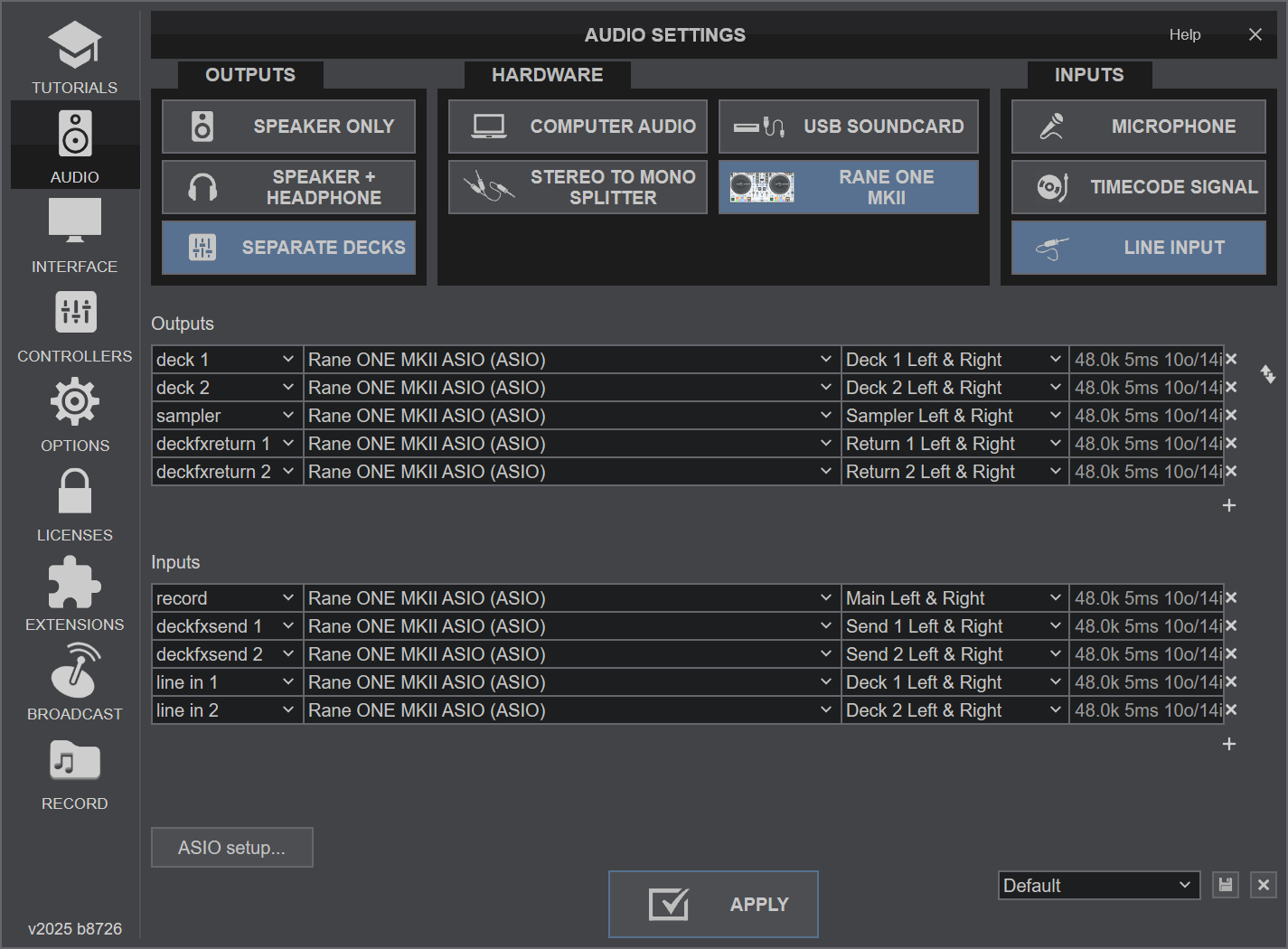

Live Inputs
The same Inputs as the one used for Timecodes, can be used as Live Inputs and route their audio signal to a VirtualDJ Deck (to apply Effects etc).
- Connect your Media devices at the rear panel of the Rane One to DECK 1/2 INPUTS sockets
- Click on the "LIVE INPUT" button to enable the Live inputs
Rane One MKII Audio Configuration with Live Inputs - Click on "Apply" button
- Click on the ON buttons from the LINE IN panels of the Default Skin to enable the Live Inputs to any Deck.
