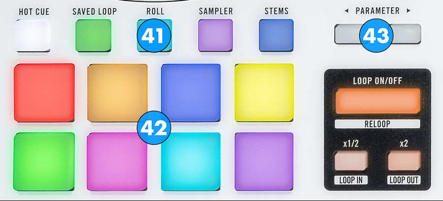

The 8 RGB Performance Pads offer various functions, depending on the selected mode. Each of the 5 Pad mode buttons offers 2 individual modes.
Press once to select one of the 5 primary modes for Pads (led will become red). When a primary mode is selected, press again the same button to get one of the 5 available secondary modes (led will become green)
The 10 modes represent a page of the PADS section on the default VirtualDJ GUI, have been pre-assigned but can be customized
- PAD MODE. Press any of the 5 available Pad mode buttons once to set the Pads to Hotcues, Saved Loops , Loop Roll, Sampler and Stems mode.
Press any of the 5 available Pad mode buttons twice to set the Pads to Keycue, Loop , Stems Roll*, Scratchbank and Stems +FX mode.* Stems Roll page is available only when Rane One MKII is connected. - PAD MODE. The 8 RGB-lit Pads offer different functionality depending on the selected mode.
- PARAMETER. These buttons control the 1st parameters of the selected pad page.
Hold SHIFT button down and then press these buttons to control the 2nd parameter (if available) of the selected pad page.
