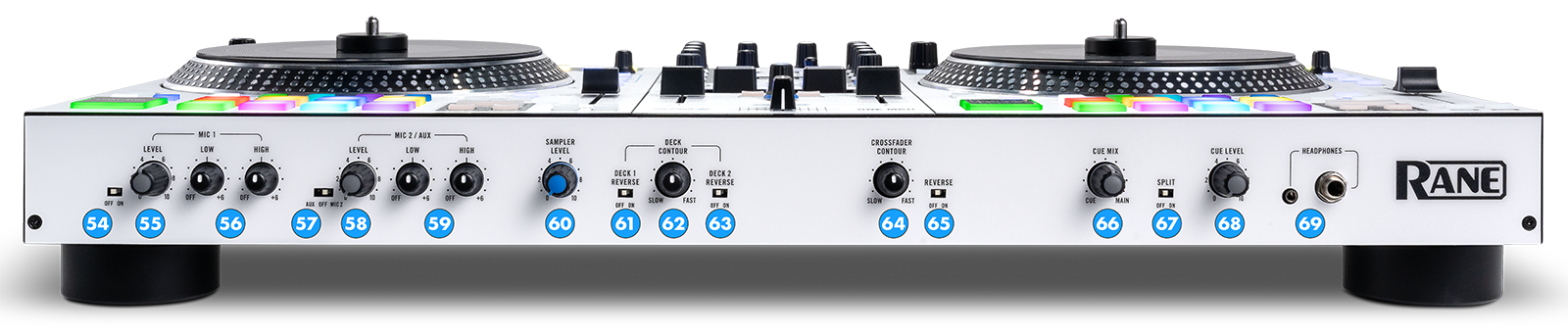

REAR PANEL
  1. MIC 1 ON/OFF. Enables/Disables the microphone 1 input (connection at the rear panel).
  2. MIC 1 LEVEL. Adjust the volume of the microphone 1 input.
  3. MIC 1 EQ. 2-Band Equalizer controls of the microphone 1 input.
  4. MIC 2 ON/OFF/AUX. Enables/Disables the microphone 2 input (connection at the rear panel). When set to AUX, the MIC 2 LEVEL and EQ knobs adjust the level and the frequencies of the AUX Input (connection at the rear panel).
  5. MIC 2 LEVEL. Adjust the volume of the microphone 2 input.
  6. MIC 2 EQ. 2-Band Equalizer controls of the microphone 2 input.
  7. SAMPLER LEVEL. Adjust the level of the sampler.
  8. DECK 1 FADER REVERSE. Reverses the direction of Left Deck volume fader.
  9. FADER CONTOUR. Adjusts the contour of both Left/Right volume faders.
  10. DECK 2 FADER REVERSE. Reverses the direction of Right Deck volume fader.
  11. CROSSFADER CONTOUR. Adjusts the contour of the crossfader.
  12. CROSSFADER REVERSE. Reverses the direction of the crossfader.
  13. Cue MIX. Blends audio signal from the Channels with PFL enabled and the Master Output in Headphones. When to minimum position, only the Decks that have PFL enabled will be heard in Headphones. When to maximum position, only the Master Output will be heard in headphones.
  14. SPLIT Cue . When enabled, the signal of the PFL-enabled Decks will be routed to one side of Headphones and the signal from Master Output will be routed to the other side of Headphones.
  15. Cue LEVEL. Adjust the level of the Headphones Output.
  16. HEADPHONES. Connect your headphones using 1/4" or 1/8" adaptor.
