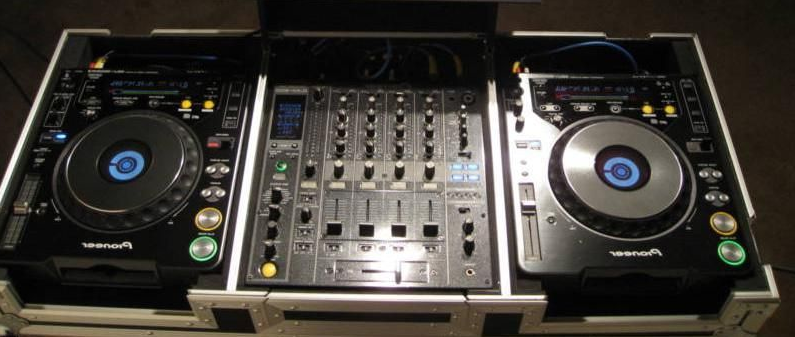

Is this the left handed version of the CDJ and 800?
