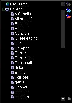

Hi @ll,
I would like to update the genre database as I see too much genres which I never use and are there by mistake.
When ripping the CD’s most of the applications don’t put the correct genre for Salsa or different styles of Cuban music, Son, Guaracha, Bolero, Cha Cha Chá, Changüí, Timba, etc. and etc. and classify it with the stupid word “Alternatief”.
Sometimes the genre is not written as I would like to search for it. See e.g. Dancehall which I use opposed to Dance Hall.
As the list is now too long with a lot of genres that I don’t use I would like to clean this up so that it shows only the one I really use.
I have already updated all my tracks with the correct genre, but still the clutter remains in the database.
Question is, how can I remove all the non existing genres from the database? Especially that Gospel. See screenshot.

Hi DJ-in-Norway, that is what I say, I have already updated all my tracks with the correct genre and the faulty genres do not exist anymore on the mp3's, yet still Virtual DJ shows these faulty genres as you can see on the screenshot. If it creates the genre once, even though that genre does not exist anymore it is not removed.
So I can now search on the correct genre for all my music and they are found and shown as such in Virtual DJ, it is only the window of the screenshot still has that sticky, eventhough if you would click on it, it is empty.
geposted Thu 04 Jun 09 @ 6:59 pm
ah, ok..
Try this,
1) connect all your music drivers
2) go to browser tab in VDJ, and choose fix for each drive
geposted Thu 04 Jun 09 @ 7:30 pm

Hi,
Thanks, now it works correctly all the wrong genres are gone, I found out that for some of the music that although I had changed the genre on the mp3 itself, it still needed to be changed in Virtual DJ.
So first step is Select the files in VDJ: Right mouse click, File Info and then Reload tag.
After that I did the steps you mentioned:
geposted Fri 05 Jun 09 @ 3:49 am
