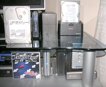

I have mentioned Firewire and the faster eSata drives in other threads. I did a video on hard drives. I mentioned issues with my Seagate FreeAgent Xtreme 1.5 TB which has USB, Firewire and eSata.Unfortunately these hard drives have known issues for dropping out, shutting down or just disappearing even though it appears to be running.
On the video i discuss "Passports" , the Segate FreeAgent and the Western Digital "My Book" issues and recommendations for users of VDJ and other DJ softs..Check it out...
