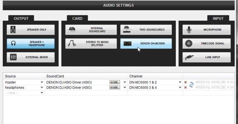

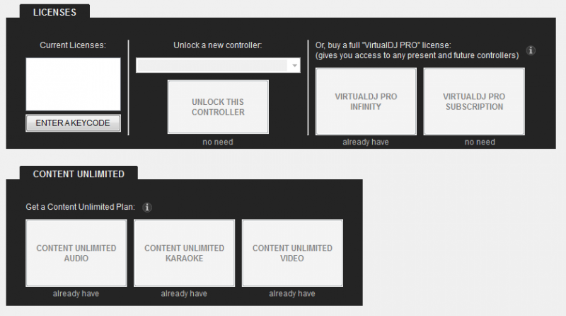

So i've got the Denon MC6000 for a couple of years now and i've recently purchased and installed virtualDJ 8.
The sound works perfectly but the controls on my denon don't work..
It works perfectly fine on traktor so I know the denon isn't broken, what i've done so far:
Updated to the latest firmware (for the denon)
Installed and updated the ASIO drivers
I have unlocked all the external controllers on vdj (see pic #1)
#1
 - Copyright A.png)
Like I said the audio comes through perfectly, even the controller is selectable in the audio setup yet not visible in the controllers section
where you map the controls of your external controller (Denon MC6000).(see pic #2 & #3)
 - Copyright A.png)
I've also tried displaying all the compatible devices and rescan several times.
(i also tried restarting VDJ8 & Denon several times)
Does anyone know how i can solve this? I'll stay online and respond further details if required.

I think you should begin with updating VDJ8 to a more recent build.
