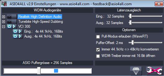

i use ASIO4ALL 2.9 together with the vci 300, it works well with virtual dj.
headphone works well with cioce's settings
Breanzu

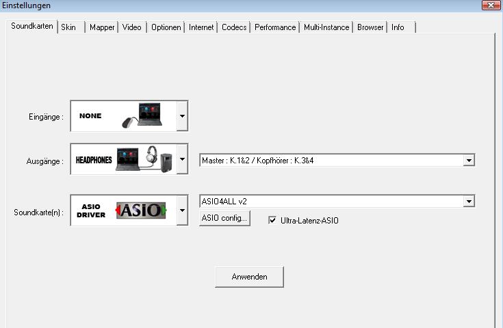

please try this setting
i use asio4all 2.9 , everything works very well with these settings.

I use the VCI-300 with ASIO4ALL 2.10 beta 1 under Windows 7 Pro 64-bit and I have no problems with it.
My setup is as per http://www.virtualdj.com/homepage/cioce/blogs/3832/_ENG__Vestax_VCI-300_audio_setup_on_Virtual_DJ_6_0_2_PC_%28or_above%29.html
Headphone pre-listening works perfectly (Check the IF_CURVE knob next to the headphone socket - This controls headphone gain and may be turned down?)
NOTE: The headphone volume knob is hardware and controls the volume of the internal sound card directly. In the default mapping, MASTER/CUE is also mapped the wrong way around, so you hear only master then turned to CUE and the cued track when turned to master. To correct, change the mapping for MONITOR_SELECT to param_invert & headphone_mix
