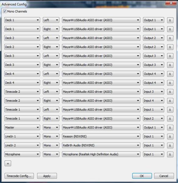

in ADVANCED sound config, choose the correct app as LINE IN for VirtualDJ :)
then enable the line in, using for example the 4 deck skin, by pressing "AUX" :)

For some reason, the applications are not showing up in the advanced config. Any idea why this is happening? is there a certain way or order in which i should open the applications?
geposted Sat 16 Oct 10 @ 3:38 pm
What apps are you using? I use both Reason 5 and Rebirth and they both show up, look at the picture
Just go to advanced config, select linein1 or linein 2 or etc, etc, next you should see the app in the 3rd drop down, click on it then just choose your input. Next make a shortcut like, "deck 3 linein 1", then start your app. In my case Reason. Reason will tell you its in slave mode. Now go hit the key you created the shortcut on and then load your track in Reason and hit play in VDJ. You should see I wave and hear that track playing. You can also look at Reason and see the track time moving.
