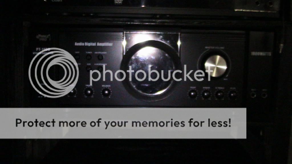

yes my amp has unbalanced inputs, here's some pics i took of it...

BSilent...looks like you can simply use RCA cables.
