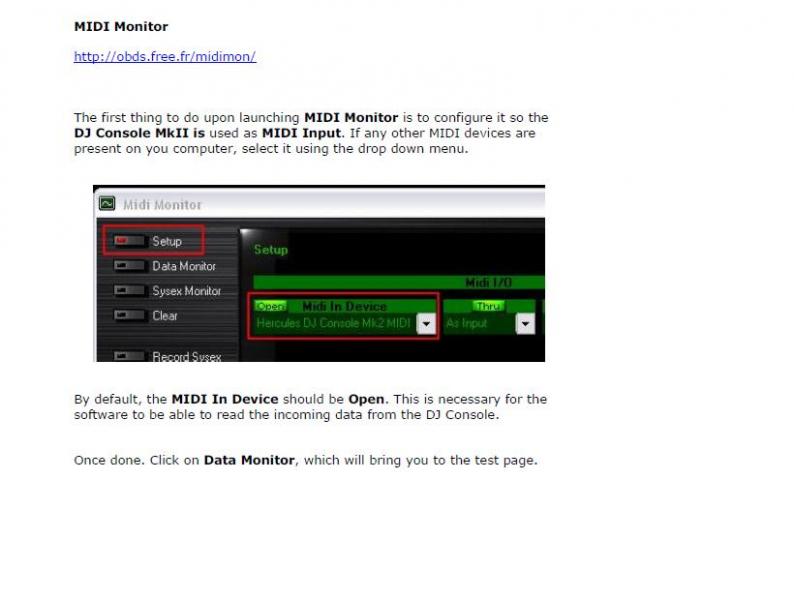

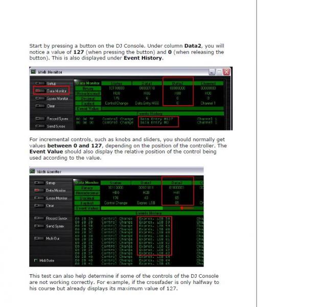

Use this mini monitor program to check your unit controls, it's a simple test, but it may be related to a latency issue in your system that's effecting your controller, are you having a problem with your curser too..?
Use the Mini Monitor and send the result to tech support and they'll respond with a fix if it's the unit..the utilities are good tools to have and use like Gamebooster, it shuts down background services you don't need and Latency checker it tests your system for latency issues...hope you find a solution...
Mini Monitor: http://obds.free.fr/midimon/
Latency Checker:http://www.thesycon.de/eng/latency_check.shtml

thank u very much...in regards to the mini monitor etc....how does it work...i downloaded it, but was kinda lost
geposted Sat 22 Jan 11 @ 11:45 am
When you start click the start button in the "Min Monitor" window, then at the main dialog window press F1 key to get all information on what to do, it's a simple program you'll read and start using it rightaway, but it's best that you understand it a little first so that will be my bast advice to you....
You can also highlight the data in the output window then copy and paste to notepad and use it as an attachment if you like as an alt, but make sure you send it to tech support so they can evaluate and give you the right advice...
