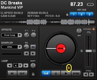

then you want smart play, just press the lock, it will sync, beatlock and play when you press play if smart play is selected.
Sync and beatlock are pretty much the same thing, they will sync to track to the nearest beat on the cbg, but beatlock will only follow the grid (which can be wrong) whereas sync if the track is stopped will match the bpm allowing you to drop the track wherever you like not locked to the grid

smart_play is like a shift button so it has to be separate to the play button, if smart_play is active it will make "play" do three things... play, sync & beatlock, if smart_play isn't active "play" will just play the track
you could use something like this for the sync button on your controller.
holding 2000ms ? deck 1 smart_play : deck 1 sync
If you press the button it will sync the track, but if you hold the button for 2 seconds then release it will activate smart_play.
