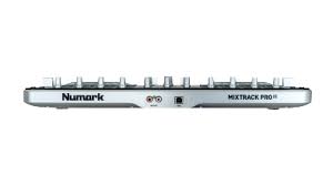

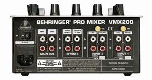

Hi,
I have just bought a full copy of Virtual DJ Pro and need an answer if possible to the following.
I have a Numark Mixtrack Pro 2 controller and a Behringer VMX 200 Mixer.
I have connected them both to the laptop using 2 separate usb cables but am unable to cue successfully using the headphones which I have connected to the mixer.
Can I rig them up together so that the Numark controllers red and white audio cables go into the Behringer Mixer which then outputs directly to my main Wharfdale speakers.
I have attached 2 pics of both pieces of hardware.
Cheers.

Depending on what you're doing, you may not need to use both the controller and the mixer, and you should be able to plug your headphones directly into the controller and use the controller's cue function.
Is there a reason you're using both the controller and the mixer at the same time?
