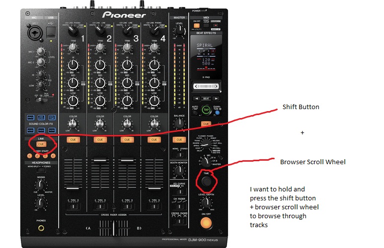

how would i map a knob to be used as a browser knob for tracks while the \"shift\" button is held?

sorry for the late reply, I forgot all about it
shift button
set '$shift' while_pressed
knob
var '$shift' ? param_greater 50% ? browser_scroll +1 : browser_scroll -1 : nothing
the red bit at the end is the unshifted action, I assume because you are using a pioneer mixer you will want to use the onboard effects, so won't want the knob to do anything in vdj when the shift button isn't pressed... unfortunately you probably can't stop the knob from changing the hardware parameters of the selected effect while the shift button is pressed.
