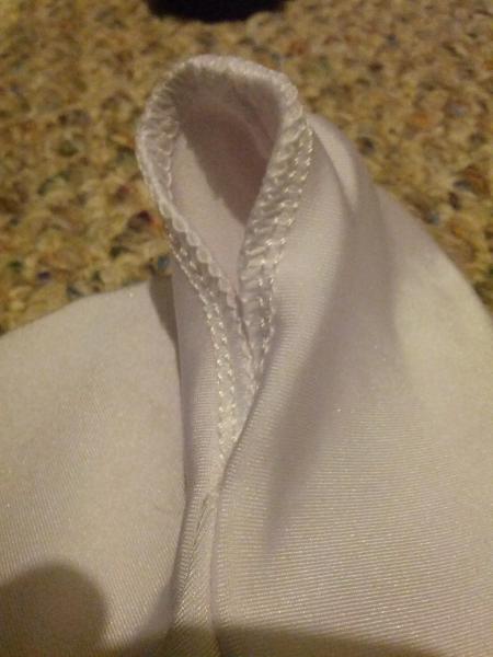

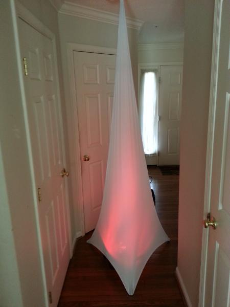

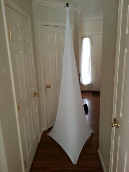

I'm kinda happy with the way this project came out.
What do you think...
