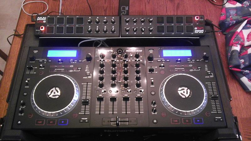

This is why I want something similar in shape and design,
Thanks to Synth and a few others here I've turned this unit into a straight beast! I like to call it my "DDJSX KILLER".
