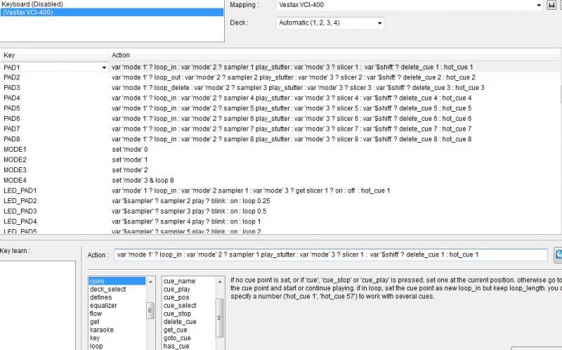

Ok I figured with some research this mapping cases the malfunction, but don't understand script so well, so can I get some advice with creating my on mapping..ok I'm using mode buttons to create 4 modes - cue, loop/looproll,sampler,slicer.
Is there someone that can help me write this code for the 8 performance pads.
geposted Fri 06 Feb 15 @ 4:19 am
These is where im at, 4 modes cue, loop/loop roll, sampler, slicer. But delete cue not working, loop in-out not working, LED's not working. Sampler and Slicer are working but not the led's. where am I going wrong?

In order to help you, you need to let us know what you're trying to achieve...
First of all:
Mode1=set 'mode' 0
Is that for hot_cues ?
Then you have
Mode3=set 'mode' 3 & loop 8
If mode 3 is slicer, why do you activate a loop when you swich to it ?
Finally the correct syntax for your pads should be:
PAD1=var_equal 'mode' 1 ? loop_in : var_equal 'mode' 2 ? sampler 1 play_stutter : var_equal 'mode' 3 ? slicer 1 : var_equal 'mode' 0 ? var '$shift' ? delete_cue 1 : hot_cue 1 : nothing
And for the leds it should be:
LED_PAD1=var_equal 'mode' 1 ? loop_in : var_equal 'mode' 2 ? sampler_pad 1 : var_equal 'mode' 3 ? slicer 1 : var_equal 'mode' 0 ? hot_cue 1 : off

Thanks...but the delete cue doesn't delete the cue. but ever thing else is great. I'm also trying to map the encoders above the pads. left on to adjust step and right one to adjust length of the slicer. If I get stuck I'll post it...
