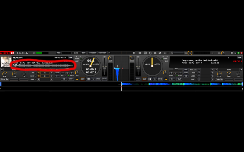

Hi. When I load a track in VDJ 8 the waveform is grey. Can someone please tell me how to change the waveform colour in VDJ 8?

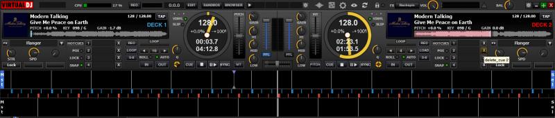

Thanks for the reply but I have already tried that. I'm trying to change the colour of the 'wave' that is loaded when I import a track. I've tried to upload an image to explain what I mean but it didn't work. The skin I'm using is Orange Juice (2 deck bottom wave).
geposted Mon 27 Apr 15 @ 8:48 am

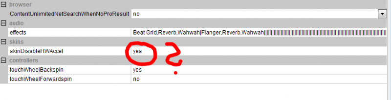

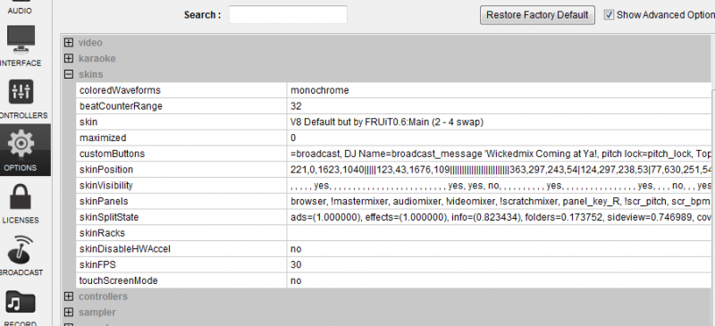

Perhaps skinDisableHWAccel is set to yes?
geposted Tue 28 Apr 15 @ 5:39 am
Have a Look on my Picture
geposted Wed 29 Apr 15 @ 7:17 am

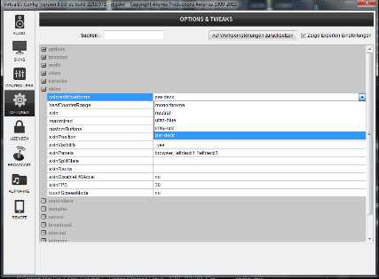

Next Step
geposted Wed 29 Apr 15 @ 7:25 am
Next Step
geposted Wed 29 Apr 15 @ 7:32 am
Thanks for the replies but this does not change the colours. I have uploaded a image to show what I'm trying to change.

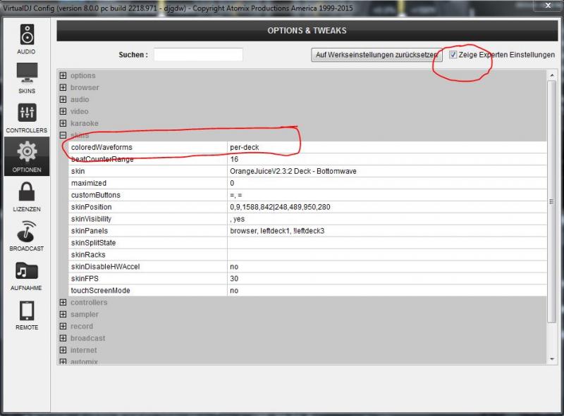

Here are my settings
geposted Wed 29 Apr 15 @ 8:03 am
Perhaps ?

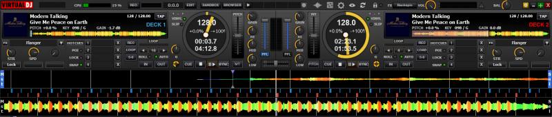

hey...great skin :-))
some intergrated gfx seems to have problems like shown. My 0815 desktop-pc with a intergrated graphic chipset had also problems with Waveforms and grids. I think its a hardware based problem. When i disable hardware acceleration, the wavesforms are also grey (but i had no visible ScratchWaves).
with no other solution, it would be interesting, what happens, if you try an external grapic card and disable the internal one.
HW acc off
HW acc on

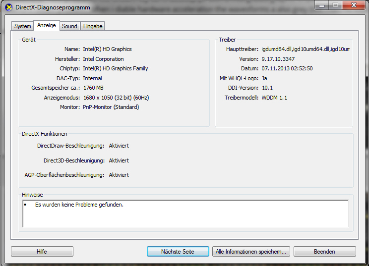

what are your DX Settings?

HW acc on

My machine is a similar story, no coloured pos waves & 4 deck default waves are so dark they're near invisible, I think for tech as old as mine is there probably isn't a solution.

what Hardware Specs ?
geposted Wed 29 Apr 15 @ 12:19 pm
Thanks for the replies and I think you guys have found out what the problem is! I'm using VDJ 8 on my desktop and it only has an on-board graphics card with 256mb in memory. I believe that this memory is also shared with my system memory. So I now think that if I install a proper graphics card onto my system then the 'song position' colour will change.

if HWAcell is set to yes and still the wave shows grey you can check if you installed dx9.
I guess you already checked or did it. Just in case you need to install:
DirectX 9C Runtime:
http://www.microsoft.com/downloads/details.aspx?familyid=2da43d38-db71-4c1b-bc6a-9b6652cd92a3&displaylang=en
Microsoft VC++ 2008 Runtime Libraries:
http://www.microsoft.com/downloads/details.aspx?FamilyID=9b2da534-3e03-4391-8a4d-074b9f2bc1bf&displaylang=en
