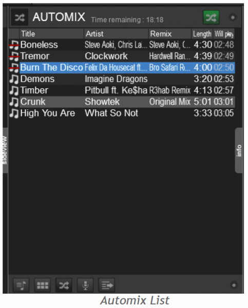

The manual was a little fuzzy on how to open, I'll show you. Select the Sidelist tab, to the right of the record case, and you will see this panel.
Select the third icon at the bottom

On page 42 it says to click on a "button" to active the automix option. (About 3/4 of the way down the page.) I don't see the "button" on the player.
geposted Tue 06 Oct 15 @ 10:22 pm
Bottom rhs window top menu bar for Automix, halfway up the screen, on the extreme right.
It turns green when selected.
geposted Tue 06 Oct 15 @ 10:31 pm
Look at my first image above.
geposted Tue 06 Oct 15 @ 10:46 pm
That's the auto beat mix button. I'm looking just to have the next song start, like a continuous play without beat mixing.
geposted Wed 07 Oct 15 @ 12:59 am
in options under "automix" set the option "AutomixMode" to "no mix" or "Full Songs"
and you should be good no mixing will occur (you may need to enable advanced options to see this i don't remember)
You will need to use that green button you say is auto beat mix to start it going automatically that just the on off for auto playing .... the type of transition is set in the options like i say above.
