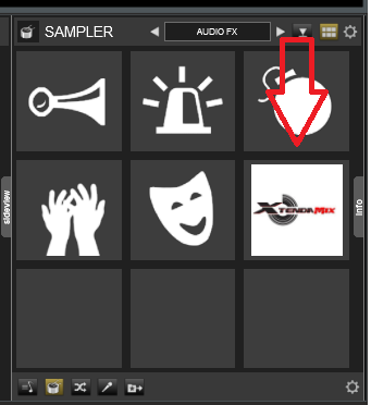

Thank you for the option of the increased image on the sampler, but I'm at a loss as to why you haven't gone full size which would give the individual pads a much better look to them, could someone from the dev team please explain this, thanks.
To anyone that hasn't been able to work out how to get a larger image in the sampler pads you have to enable "all settings" first in the options search bar drop down, then scroll down to the sampler section.

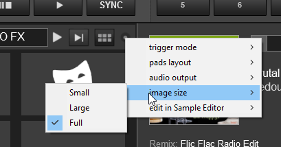

Image size is accessible from the Sampler Options button in the Sampler view of Sideview. Not sure why people need to go into Settings.

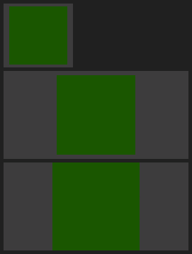

As an example, here is what I mean:
Image 1 is a standard cover on a pad.
Image 2 is the same pad, but resized due to the sizing of the sampler window.
Image 3 is how it would look resized to fill the pad completely.
I actually think image 3 would look a little odd.

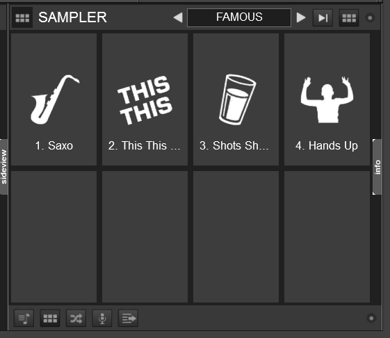

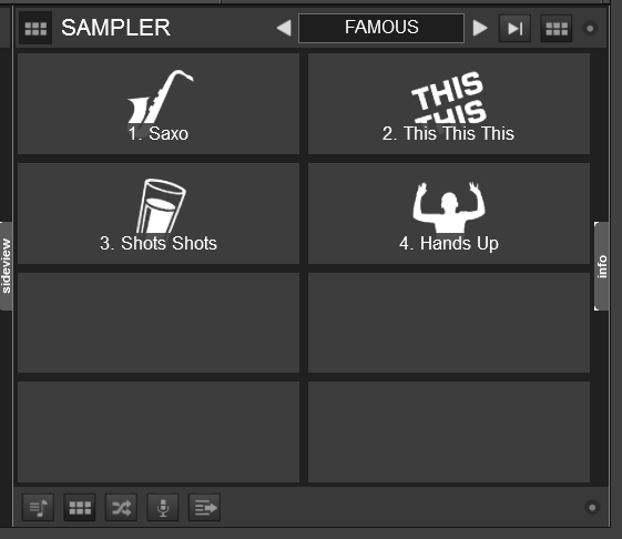

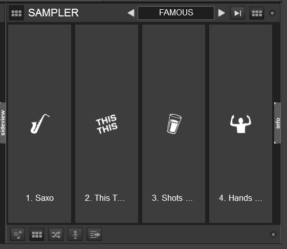

That's the exact same sampler area (no resizing) but with different pad layouts.
Remember that by default on VirtualDj 8 the sampler pad view layout get's calculated automatically depending on the connected controller.
How would you treat those pads (graphic wise) ?
