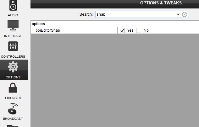

if you are stetting beatgrids u can snap cue points to the grid and just get close and u will be fine
geposted Mon 21 May 18 @ 8:17 pm
Thanks for the reply. I usually mix rap and funk music, the type of music that can't really be beatgridded anyway, and could do without that setting being turned on all together, especially if it causes problems like this drift.
I guess the thing I'm trying to do is be able to use the deck like a jog wheel when I'm trying to line up and set a cue point. No matter what controller I've used, there's never been much of any drift that I've experienced.
