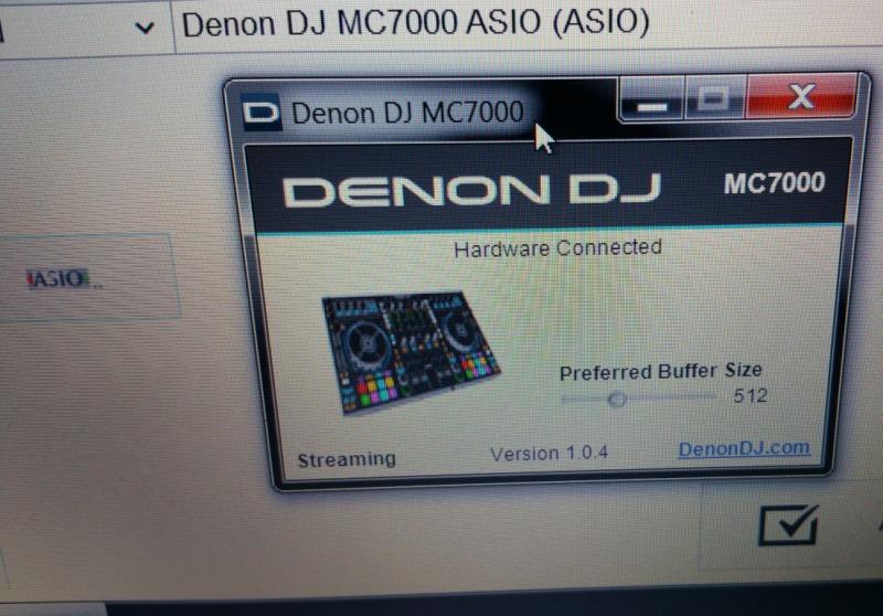

Try set the audio asio buffer higher.. 256 or 512 samples works for most..
And if needing higher than that, use the latency checker tool to see what prevents real time audio
https://www.resplendence.com/latencymon
You adjust the audio buffer directly on driver if its Windows & Asio.
Else use the latency setting in VDJ and same values (256 or 512, macOS and windows wasapi)
