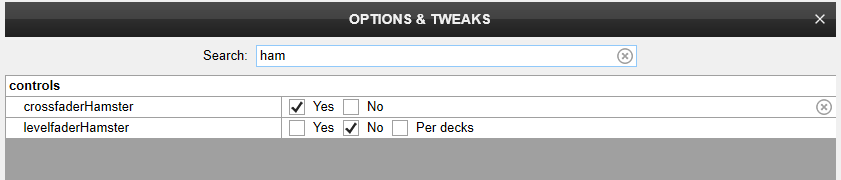

I have changed the hamster setting to "no" over and over and it does not seem to stick when I reload VDJ.
I've also gone directly into the settings XML and checked and it says:
<crossfaderHamster modified="yes">no</crossfaderHamster>
But the options screen shows:
I have also tried adding to the ONINIT:
crossfader_hamster 0
I have tried all permutations and it will just not stick. Pleaes help.

Thanks. that produced some bizarre results. As I mentioned earlier, I always have it off.
1. My controller does not have a hardware setting for hamster and so it can't be manipulated. So the hamster does remain set at "no".
2. The issue is related to what Rune was suggesting. I hope you can follow this:
Scenario 1: (SW hamster = on, and HW hamster/reverse = off) - an open crossfader will play both channels. A closed fader regardless of the side will close both channels. So if I have both playing and move the fader to the left, both channels are cut off and if I move to the right both channels are cut off.
Scenario 2: (SW hamster = off, and HW hamster/reverse = off) - gives the expected result
Scenario 3: (SW hamster = off, and HW hamster/reverse = on) - gives me hamster mode
Scenario 4: (SW hamster = on, and HW hamster/reverse = on) - repeats scenario 1
So it appears that the SW hamster mode is overriding the HW mode and provides a strange compromise.
The other issue is that, the HW switch is acting as a toggle instead of a setting:
1. If I have the SW set to no hamster and hardware set to yes on hamster, then flipping the switch makes the SW go to yes on hamster and of course the hardware will now be no. And vice-versa.
2. The only way to make sure they align is to set both the software and hardware setting the same, then move the HW switch will toggle the software switch in the same way.
The software should check the hardware to see if hamster is a capability. Then if it is, it should check the state of the hardware button/switch and then change the SW setting to match the hardware setting and should not allow the user to change the SW setting when said HW is connected.
At this point, I can set it so that the two align and hope that everything stays the same from now on.
