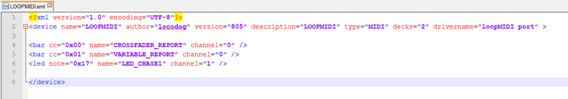

<?xml version="1.0" encoding="UTF-8"?>
<device name="LOOPMIDI" author="locodog" version="805" description="LOOPMIDI" type="MIDI" decks="2" drivername="loopMIDI port" >
<bar cc="0x00" name="CROSSFADER_REPORT" channel="0" />
<bar cc="0x01" name="VARIABLE_REPORT" channel="0" />
</device>

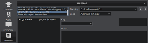

Step 2- Add a mapping in VDJ to the existing LOOPMIDI mapping (which was empty by default) :
<map value="LED_CHASE1" action="get_var '$Chase1'" />
BTW, the mapping file is placed in the the VirtualDJ mappers directory (in my case C:\Users\myname\Documents\VirtualDJ\Mappers)
Step 3- Create a VirtualDJ device for LOOPMIDI (there was none) with the filename LOOPMIDI.xml in the VirtualDJ device directory (in my case C:\Users\myname\Documents\VirtualDJ\Devices) with the code:
<led note="0x17" name="LED_CHASE1" channel="1" />
</device>

<map value="SEND_PC_02" action="get_var $SEND_PC_02" />
<map value="SEND_PC_03" action="get_var $SEND_PC_03" />
Device file:
<!-- Note -->
<led note="0X00" name="SEND_NOTE_00" channel="1" />
<led note="0X01" name="SEND_NOTE_01" channel="1" />
<led note="0X02" name="SEND_NOTE_02" channel="1" />
<led note="0X03" name="SEND_NOTE_03" channel="1" />
<led note="0X04" name="SEND_NOTE_04" channel="1" />
<!-- Program Change -->
<led cc="0X00" value="0x00" name="SEND_PC_00" channel="1" />
<led cc="0X00" value="0x01" name="SEND_PC_01" channel="1" />
<led cc="0X00" value="0x02" name="SEND_PC_02" channel="1" />
<led cc="0X00" value="0x03" name="SEND_PC_03" channel="1" />
