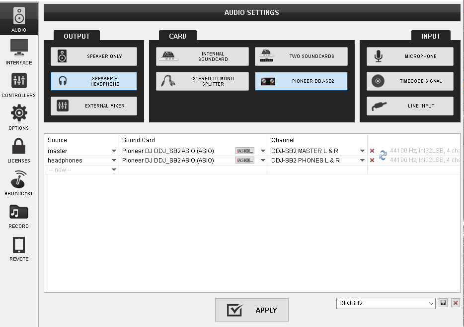

AUDIO Setup
The unit has a pre-defined Audio setup and a special button in the AUDIO tab of Config to provide that. When the pre-defined audio configuration is selected, speakers need to be connected to the rear Master Output connection (RCA cables) and your Headphones plugged to the rear Headphones socket of the DDJ-SB2.
Alternative Audio setups can be applied in the same window.
