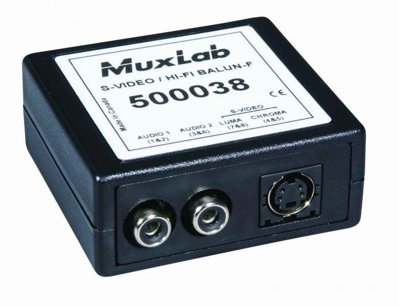

I have S-Video+Audio Baluns that use Ethernet as the middle between the Baluns. You then make or get a 100\' Ethernet cable. I have used it over 250\' with no problem but it says it can go up to 1000\'. Works great even though it is standard def but it is better than nothing.
You can get two for under $100
http://www.svideo.com/500038.html
