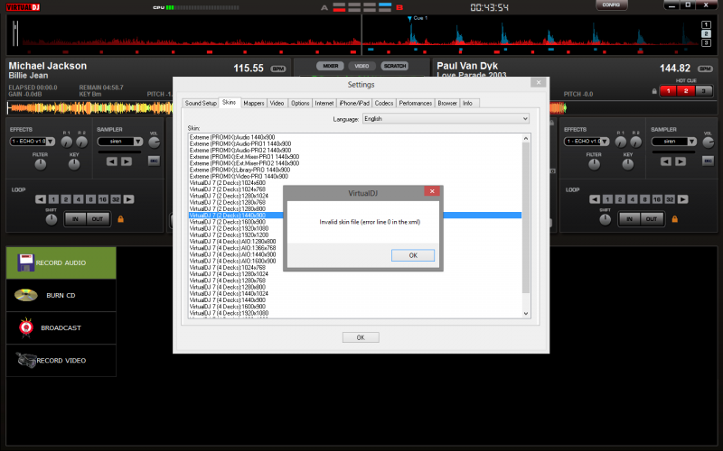

system crashed
geposted Thu 21 Mar 13 @ 6:49 pm
@djmila
"Invalid skin file" (error in line 0 in the xml)
This is not a crash but clear message telling you that there is something wrong with the skin you are trying to load, probably incompatible with this version or modified).
If you get this error at startup you can always use the registry tool and reset to the default skin.
