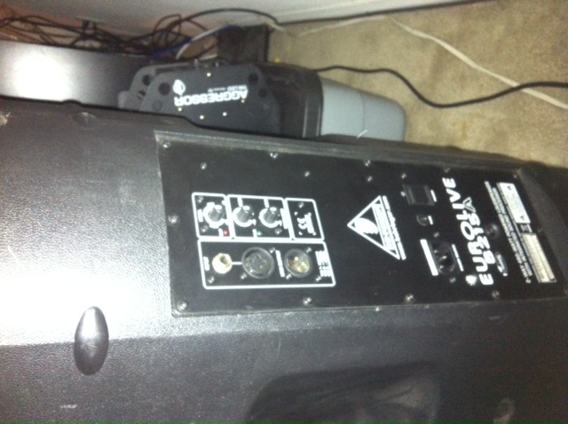

Thank you guys once again for the input. Here are the pictures..JPG)
Once again the Eurolives are the 2 tops and the EV is the Bass. All of them powered.
