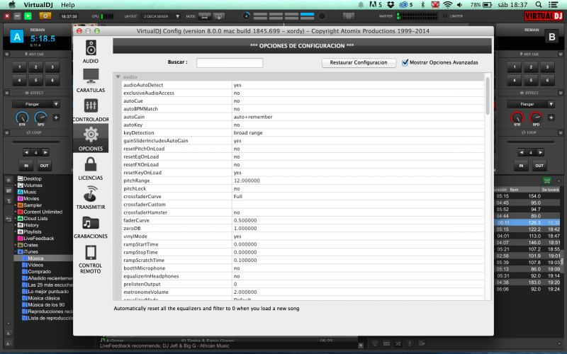

So to disable bpm matching 100% I have set autoCue, autoBPMMatch, autoKEY to NO.

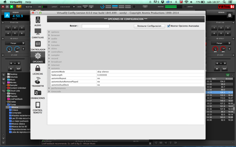

And to make the cue work as I need I also have to set AutoMixMode to skip silence and fadeLenght to 0.
But this still happens!

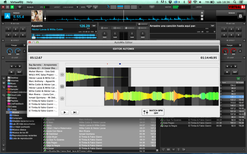

I think it's related to BPMmatching, to calculating BPM, or to the calculation of the automix, because, when a new song starts on automix, and starts loading the next song, sometimes, it shows the "wide" and late startpoint, and when it's about the half loading the song, it change the start point to the "narrower" and it places it just on the beginning of the file.
(I might have explain myself poorly. I can record this on video if you need it)

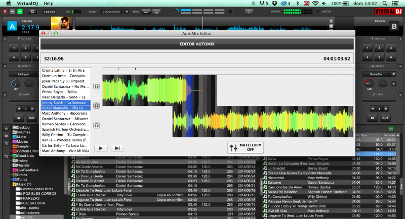

Today I did a 5h salsa&bachata gig, and I had to change a lot of starting points in AutoMix... not every of them, but about 60% or 70% of them.
When I clic on Edit Automix and then on a track with a strange startpoint, "MATCH BPM" is ON, even tought I disabled every beatmatch and smartbpm on the VDJ8 config.
