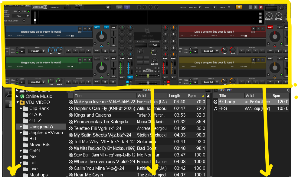

Hi, I have been using a custom VDJ skin created for me under specific ways of function as I use it for broadcasting. The problem it cannot update (custom). I've just discovered Combat skin (dark) and being similar to the way I work I would love to use it if it was possible to have the working part of the skin larger on first opening the skin. The reason is I use it with OBS to the right and I have a lot of browser and hardly any working machine. Can anybody help please as in is it possible to do and how? Thank you. Kim
