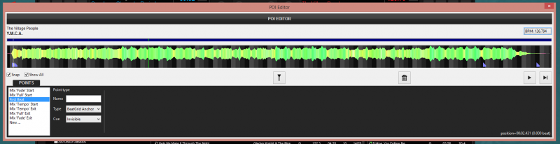

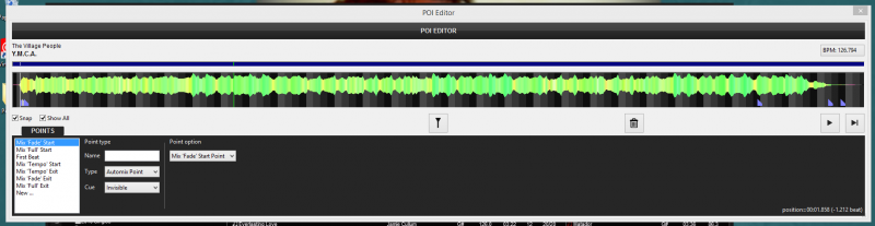

maybe I'm just crackin up, but I've just(using batch) analysed all my music again(takes two days for my gig laptop) no problem. But still some songs have the fade mix out poi after the end of the track, even behind the full mix poi. So I just found a freshly analysed track in a playlist that I'm preparing for tomorow(lol i can't spell that) thgat had a big dead air on the end of it. Here's the before and after effect of then using the Re-Analyse thing;
before
after
hangonamo'
that's not the one,I know that one already. But in build 2048 if you right click on a track there's a new option "reanalyse" ... that's the one i want.
before
after

hey loco, oh yes, this is what put me onto the right track, it's from Adion in the bug report forum about "when will smartmix work" or somethin like that (by the way.. I have never used smart mix and I never will, if I want to cut tracks I do it myself, there's no machine that can bang a song in like I can :)
"-Try the latest beta version (currently build #2048) and rescan both songs for bpm/poi's, then try again and see if the problem remains"
when he says rescan both tracks maybe he means seperately, I think not thru batch, but with the Re-Analise BPM etc thing on the right click option.
up untill now (I've been testing for one and a half days) and this has corrected every song that up until now has had the fade poi set somewhere long after the full poi and long after the end of the song.
