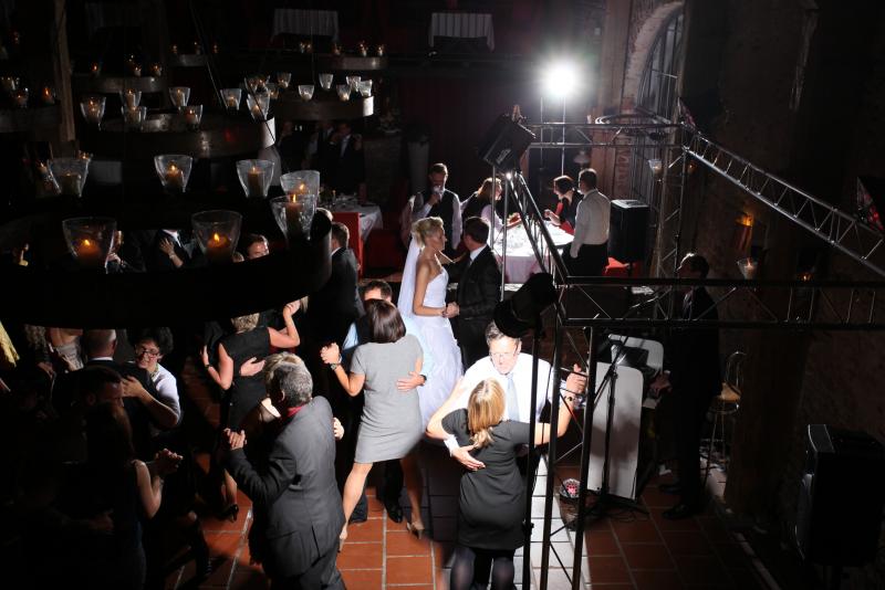

that sounds pretty good!
yes if the singers wander in front of the speakers you're always gonna get problems with feedback/howlround. That's why I try to get my speakers as far apart, and, away from my mics as poss. But, as a suggestion, I would say that maybe if you learn to try to change the levels directly on the mixer instead of on the amp it would be better, think of your mix desk as a controller, use the sliders to adjust each channel(maybe just the mic of the inhibriated person that's shouting into the mic, been there,done that,,,lol,,,) as the need may be.
I've seen some very good vids on it,,,somewhere,
and maybe you should consider how you are placing your speakers. I try to have my main speakers well in front of me/stage area, only my monitors are near me and I can't get feedback from my monitors.
edit, just noticed that that was the wrong pic, sorry.
