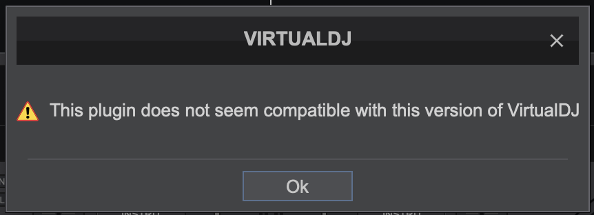

So on Mac OS, Virtual FX Seems to work with .ini files that contain the standard virtual fx script format.
i.e [autoparams]
Slider DIAL A 0=2048
String DIAL A 1=
String LABEL A 2=
Slider DIAL B 3=2048
String DIAL B 4=
String LABEL B 5=
Slider DIAL C 6=2048
String DIAL C 8=
String LABEL C 7=
Switch BUTTON 1 9=0
String BUTTON 1 10=
Switch BUTTON 2 11=0
String BUTTON 2 12=
Switch BUTTON 3 13=0
String BUTTON 3 14=
String OnStart 16=
String OnStop 17=
String Buffer 18=
Anything esle not following this format in the .ini file doesnt work. I will give you an example using the catchspin plugin.
the Instruction was to delete everything in the .ini file and replace it with the script posted by Locodog quoted above. That doesnt seem to work as intended . Instead after re-opening the .ini file for catchspin , i find that new additions have been added to the file despite everything being deleted initially. See Snippets below.
Script 1 is the Intended Script : autoparams]
String OnStart 16=set 'howMany' 0 & set 'trackT' `get_time 'elapsed' 44100` & repeat_start 'CatchSpin' 30ms & param_bigger "get_time 'elapsed' 44100" "get_var 'trackT'" ? set 'trackT' `get_time 'elapsed' 44100` & var 'howMany' 2 ? gain -22% & cycle 'howMany' 1000 & effect_button 'echo' 2 1 & effect_active "echo" & set 'beatvar' `get_bpm & param_1_x & param_multiply 60000 & get_var 'beatvar'` & param_cast "ms" & repeat_start 'rsiOnebeat' & effect_active 'echo' off & repeat_stop 'rsiOnebeat' : cycle 'howMany' 1000 : set 'trackT' `get_time 'elapsed' 44100` & var_smaller 'howMany' 3 ? set 'howMany' 0 : gain +22% & set 'howMany' 0
String OnStop 17=repeat_stop 'CatchSpin'
Script 2 is what is generated after saving and trying to use the effect.[autoparams]

Hi,
VDJ v2025-m b8615 running on a Macbook Pro M3 here.
Unable to access the FX
geposted Sun 01 Jun 25 @ 9:28 pm
Any thoughts?
Thank You!
Thank You!
geposted Sun 01 Jun 25 @ 9:29 pm
@cesarbua
Yep I'm not paying apple $100 a year for the privilege of maintaining a free plugin that worked fine with older macs until they moved the goal posts.
I might open source the code on this one.
geposted Sun 01 Jun 25 @ 9:51 pm
