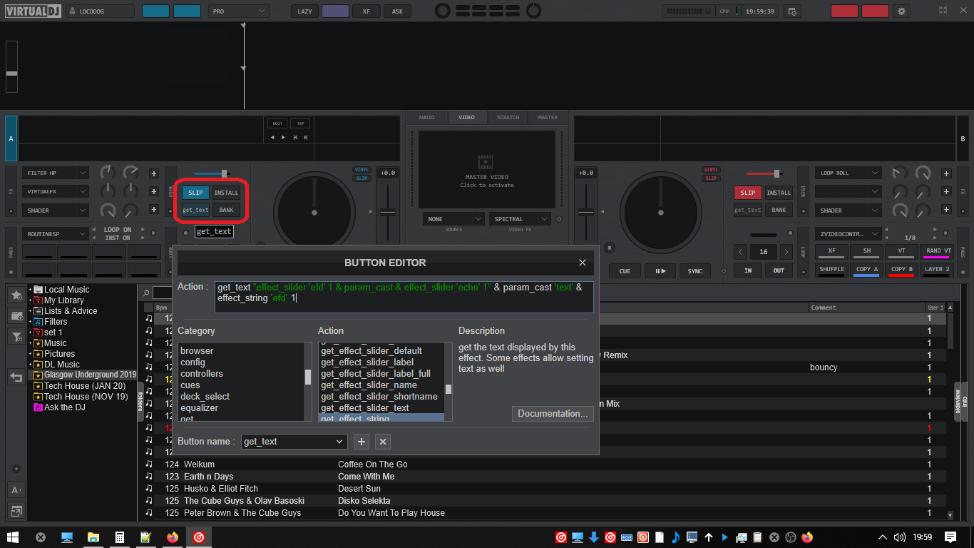

And if you wanted to "program" the fx from inside vdj with a custom_button the script to do this would look like below
effect_string virtualfxCut 1 "effect_slider virtualfxCut 1 & param_cast & effect_slider cut 2" & effect_string virtualfxCut 2 "get_effect_slider_text cut 2" & effect_string virtualfxCut 3 "effect_slider virtualfxCut 2 & param_cast & effect_slider cut 1" & effect_string virtualfxCut 4 "get_effect_slider_text cut 1" & effect_string virtualfxCut 5 "effect_slider virtualfxCut 3 & param_cast & effect_slider cut 3" & effect_string virtualfxCut 6 "get_effect_slider_text cut 3" & effect_string virtualfxCut 7 "effect_button cut 1" & effect_string virtualfxCut 8 "effect_button cut 2" & effect_string virtualfxCut 9 "" & effect_string virtualfxCut 10 "effect_active cut on & ( effect_button virtualfxCut 1 on ? effect_button cut 1 on : effect_button cut 1 off ) & ( effect_button virtualfxCut 2 on ? effect_button cut 2 on : effect_button cut 2 off )" & effect_string virtualfxCut 11 "effect_active cut off" & effect_string virtualfxCut 12 ""

VERY COOL! Nice work. I'm trying to play around but as I'm screwing with some the settings / dials I have a difficult time getting it back to your defaults w/o copying the params over again. I only have 2 dials on my skin and it's a bit over my head with the FX flyout panel. Is there a reset to get back to your default? Also what's going on with the flyout and all of the buttons. This effect seems to work on the track I'm fading INTO - what's your take? I'm just cracking the surface but love the idea of what the capabilities are!
To clear all the effect_strings needs a very quick double tap on the clear button.
I kind of agree the single fx skin display could be better, but I try to make dial 3 something you might only adjust rarely.
The default settings are all dials at 12, but that's just virtualfx and not related to the "new.ini" variations, I suppose if you wanted to to could have a reset to default button on the fx, if you had a button spare.
Buttons on the fx gui for SweepNoise and some others are there to take advantage of the "get_text" action in vdj script,
anything script inside ` ` in a get_text action is converted to a number, so it means you can use variables in ways that normal scripting wouldn't allow.
But once you have built a script with get_text, you have to send that script somewhere to be called, [unfortunately there is no action like this that could call it, param_cast 'script_string'] so the string is built by the onStart and sent to a button, onStart also presses the button to call the script.
The whole thing is very open ended, so some uses I have don't use sliders or buttons at all, the fx just holds a script without using a custom button/pad/controller key. Others when called will unload themselves and call in other fx with certain presets in its place.

I call this one catchSpin, here's the .ini
[autoparams]
String OnStart 16=set 'howMany' 0 & set 'trackT' `get_time 'elapsed' 44100` & repeat_start 'CatchSpin' 30ms & param_bigger "get_time 'elapsed' 44100" "get_var 'trackT'" ? set 'trackT' `get_time 'elapsed' 44100` & var 'howMany' 2 ? gain -22% & cycle 'howMany' 1000 & effect_button 'echo' 2 1 & effect_active "echo" & set 'beatvar' `get_bpm & param_1_x & param_multiply 60000 & get_var 'beatvar'` & param_cast "ms" & repeat_start 'rsiOnebeat' & effect_active 'echo' off & repeat_stop 'rsiOnebeat' : cycle 'howMany' 1000 : set 'trackT' `get_time 'elapsed' 44100` & var_smaller 'howMany' 3 ? set 'howMany' 0 : gain +22% & set 'howMany' 0
String OnStop 17=repeat_stop 'CatchSpin'
1.5.1
How do I save it as an audio plugin????
get virtualfx [from inside vdj]
turn it on [it won't do anything yet]
close vdj, go in to your sound effects folder in windows
rename
virtualfx.dll
to
catchSpin.dll
rename
virtualfx.ini
to
catchSpin.ini
open catchSpin.ini in a text editor and replace all the text inside with the ini from above
open vdj and you now have a catchSpin plugin.
