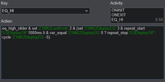

Z1 append the eq scripts with _freq
eg
eq_high_freq
eg
eq_high_freq

Thank you - they already have that, and it all changes when the X1 mk3 goes from EQ to Stems.

I checked again.. missed the _freq bit and it works perfectly!
Hm, no.
I guess you didn't understand what you were proposed to do:
Your "HI" eq knob should be mapped as eq_high by default on Kontrol Z1
You were asked to change it to eq_high_freq
The difference between the 2 scripts is that eq_high will take into account the STEMS configuration (eq mode) while eq_high_freq will ALWAYS control the frequency equalizer.

Am I adjusting the wrong thing here? The only mention of high_eq is "high_eq_slider", and changing that to "high_eq_freq" doesn't seem to have any effect. The Z1 still switches modes when the X1 does. Is it not possible to disable that functionality and have them both be able to switch modes independently, as they do in Traktor Pro?

Are you sure you used the correct names ?
It should be eq_high_freq
The rest of the script is there just in order to control what the screen shows
