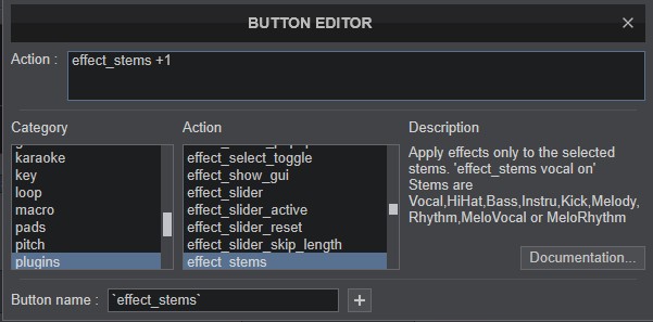

I've got a Custom button mapped to the PITCH BEND - button on my Numark NS4FX like this:

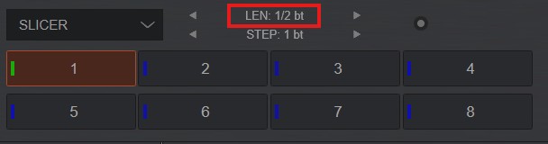

Is it possible to map an alternative use for PITCH BEND - so that, if I'm also holding down one of the PADS, while in Slicer mode, the LENGTH parameter for slices is changed?

effect_active slicer ? slicer length -1 : effect_stems vocal
geposted yesterday @ 4:30 pm
Beautiful, thanks!
