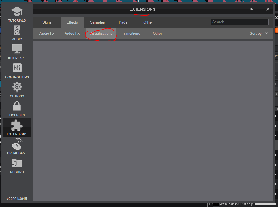

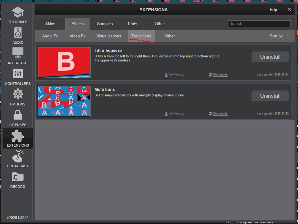

Options -Extensions - Visualizations showing grayed out nothing?
a couple of others showing limited options that have full menu previously -not sure if by design or not
In VDJ2025, you could "uninstall" or "reinstall" internal plugins from the extension page. in VDJ2026, this is now done in the fx list editor, so the extention page now only shows real third-party plugins (and nobody made any for visualization)
