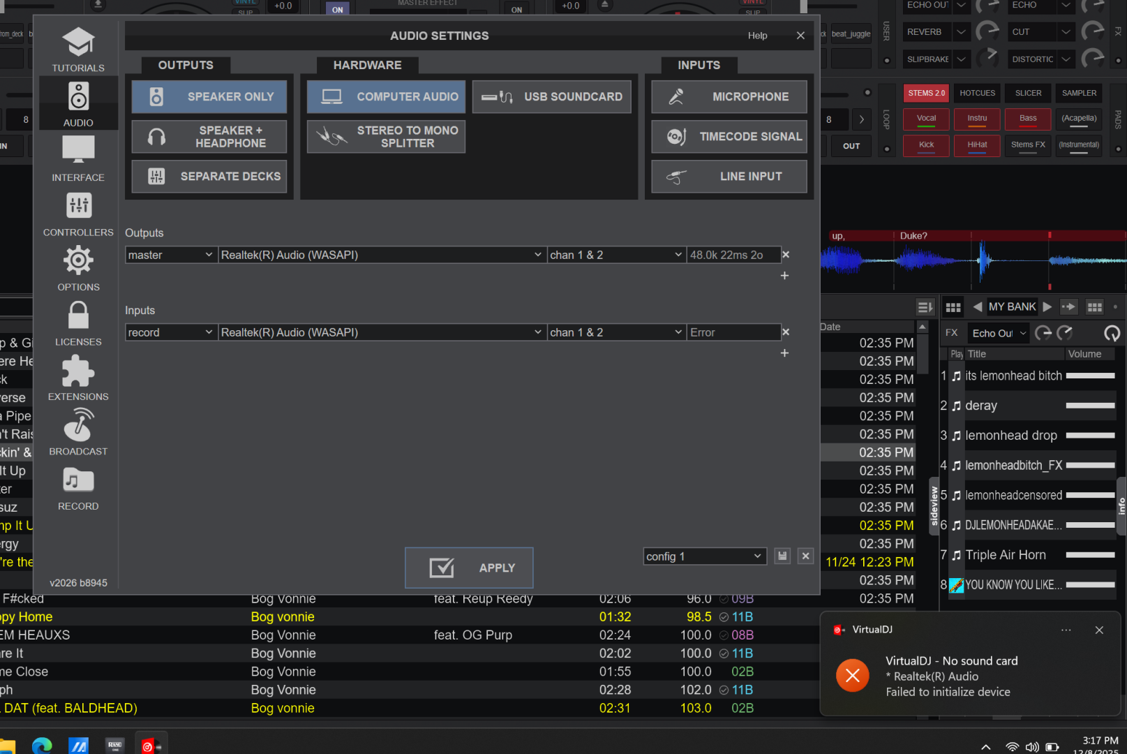

I updated to Virtual DJ 2026 and now it wont recognize the internal soundcard. Works just fine when controller is connected. I restarted and changed the audio settings but still nothing. I also tried the exclusive access option & still doesnt work.

I believe the "failed to initialize" message derives from the fact that you have defined a sound input on your audio config (for recording) without it providing any input channels (most likely because there are not any at this point)
Remove the recording input and try again

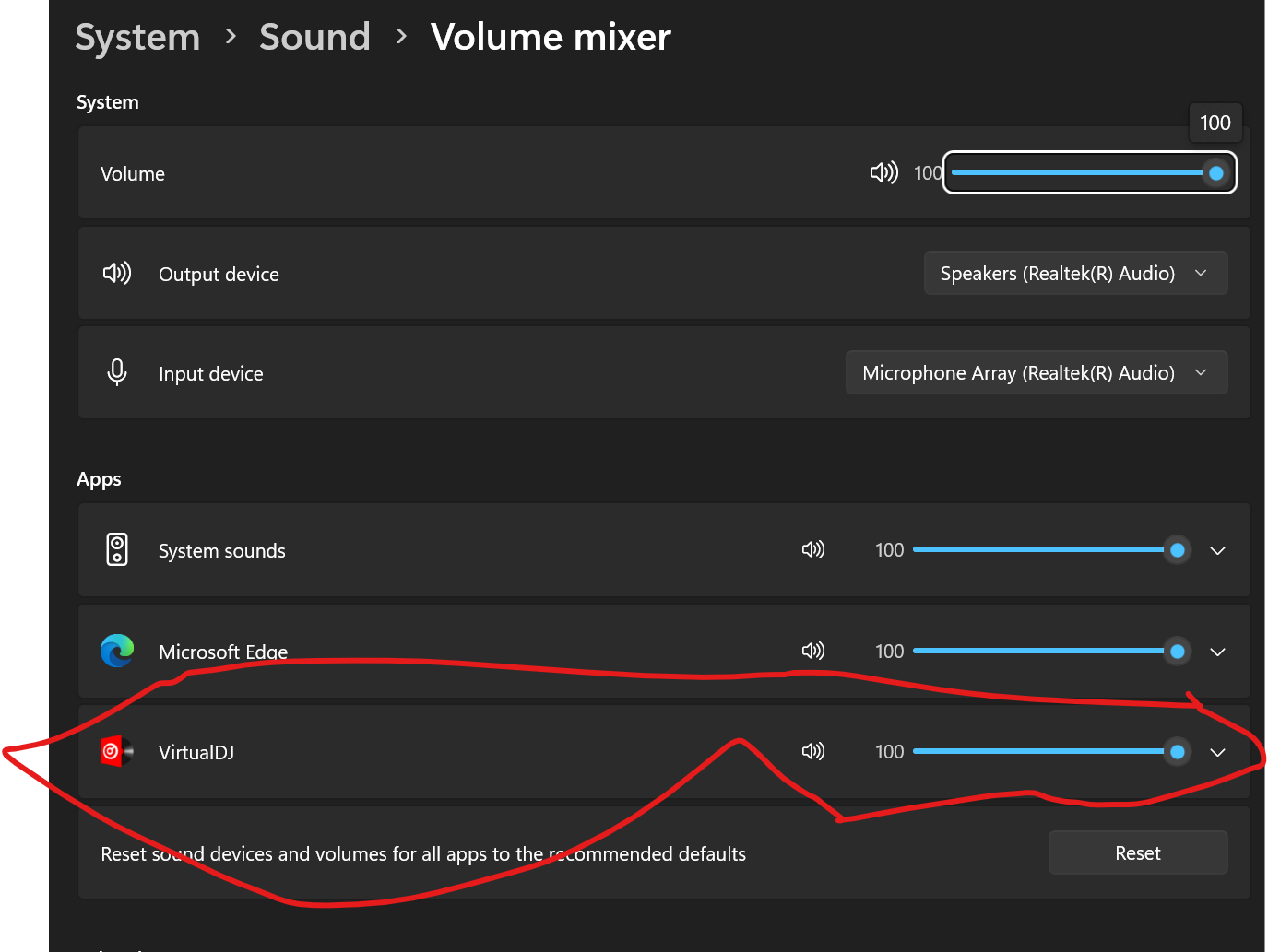

That was a screenshot of one of the many things I tried. Since then I removed the input altogether and still nothing. Now it doesnt even give me the "failure" message. Still no sound. I opened the sound settings and it shows virtual dj there but still no sound.

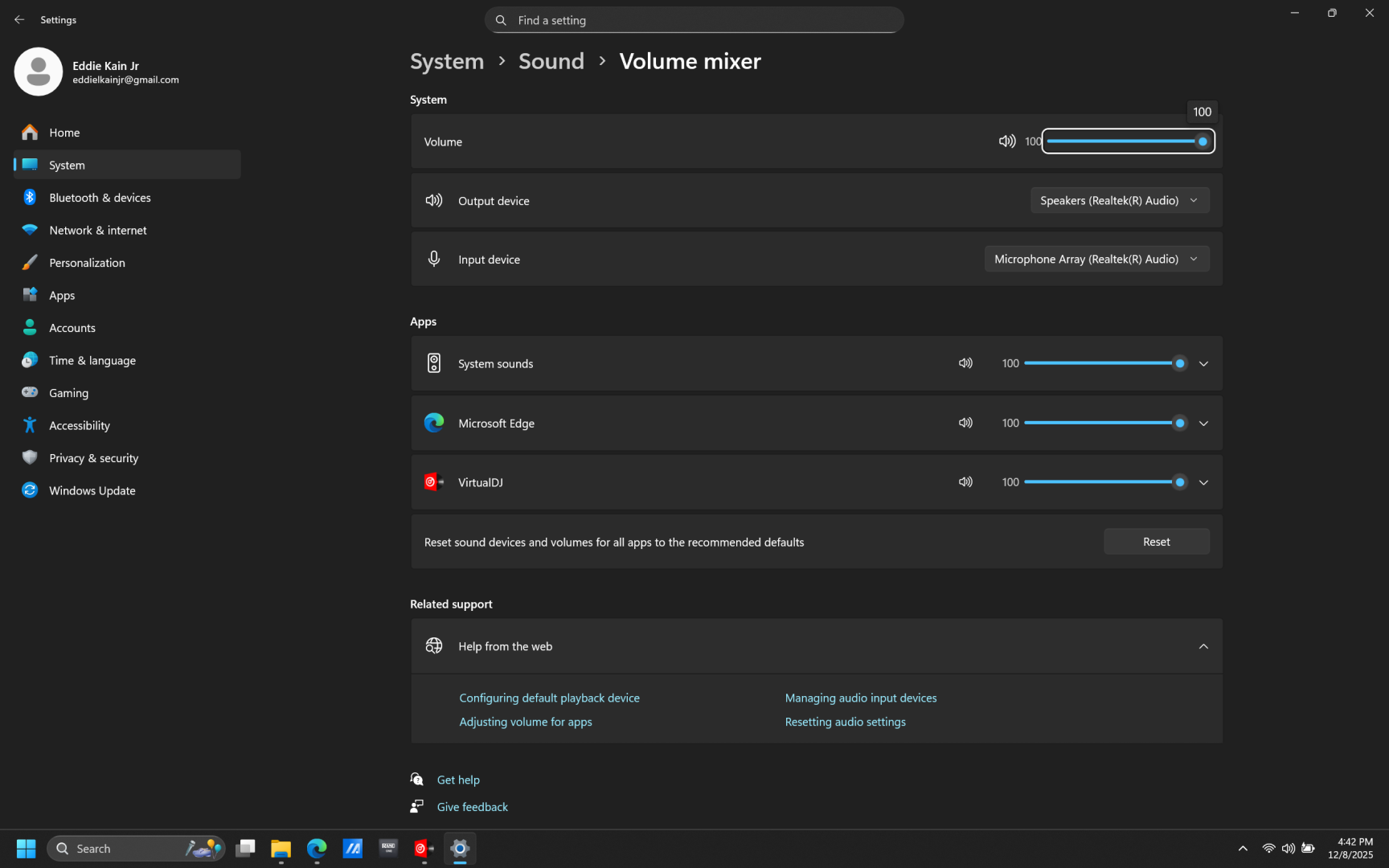

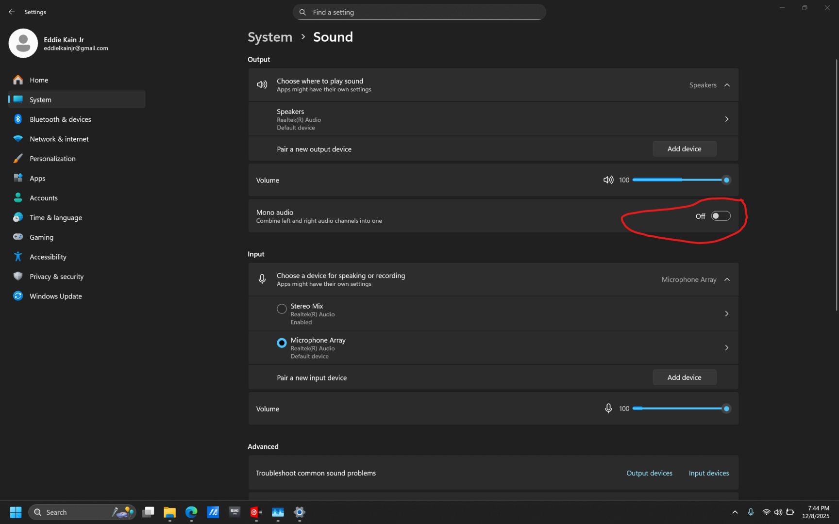

Can you post a screenshot further down the same Windows settings page ?
geposted 8 hours ago

I believe I figured it out. This was switched to on for some reason. I didn't even know it existed but soon as i turned it off the sound immediately came back on. It seems to be working so far. If that changes, I'll add to this post. Thanks to everyone who tried to help.
