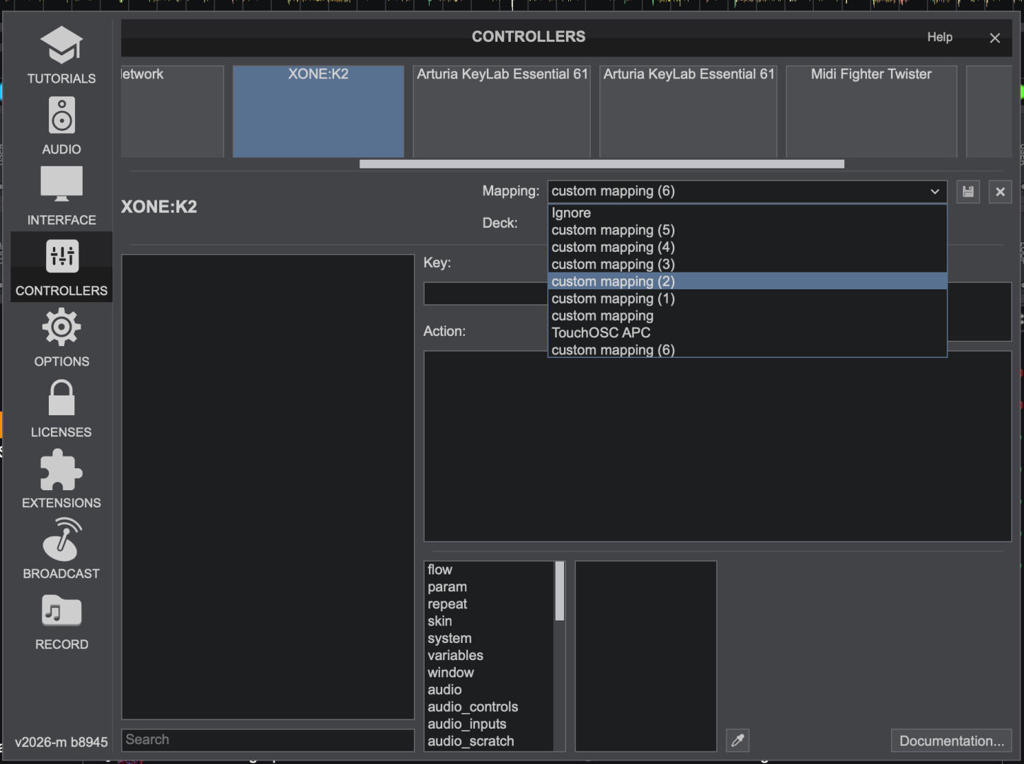

After installing the latest update today, my Xone K2 and Midi Fighter Twister both stopped working. They were working perfectly before the update.
Their device configs now appear to be missing in Settings (see screenshot). Both controllers are powered on and recognized by my system, but unresponsive in VirtualDJ.

As the system report noticed, it appears you have set disableBuiltInDefinitions to yes, so put that back to no.

thanks, that worked!
is that something that can change on its own, I don't recall fiddling with it, but maybe the update resets this?
geposted 15 hours ago
No, updates don't change settings, and the default for this setting is off as well, so even if it did reset it would be off
