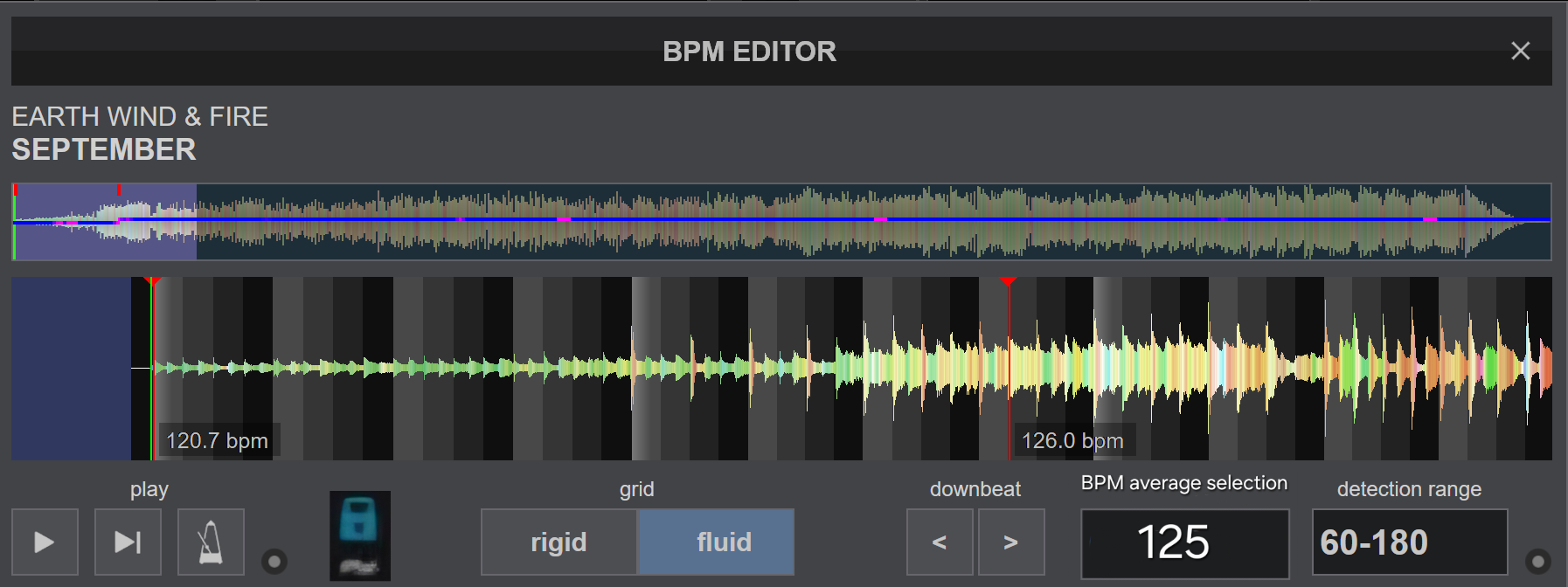

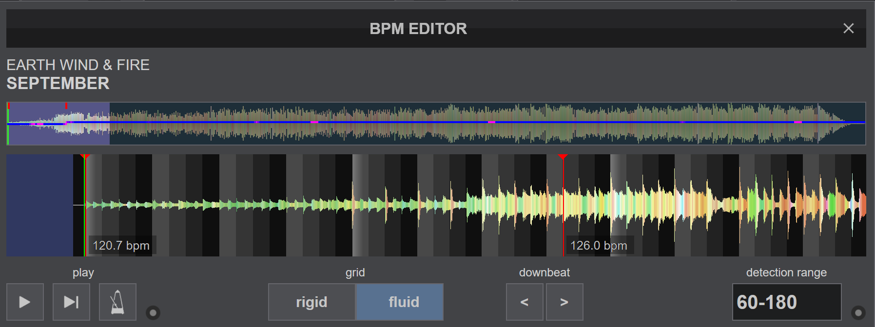

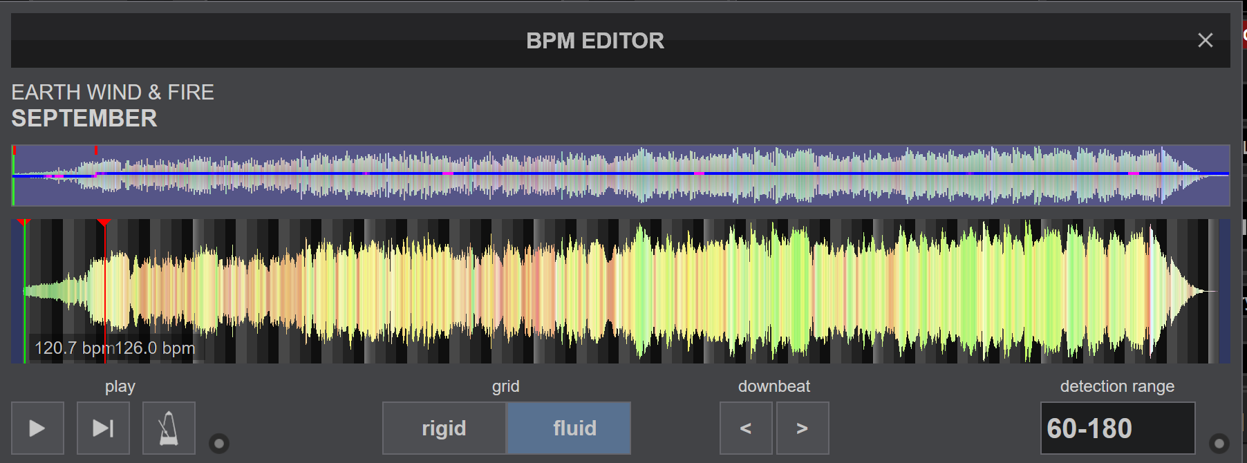

Just loaded Earth, Wind & Fire September and analyzed it for fluid.
The intro is around 120bpm and the rest of the song is around 126bpm. I loaded it in the deck and the readout DOES change when the song gets faster.
If I then click for the BPM Stabiliser the whole track stays at that selected BPM. Is that not the expected behaviour?

If I’m interpreting the screenshot correctly, the track starts at 120 BPM and then, roughly halfway through, shifts to 126 BPM.
From a mixing standpoint, this distinction is critical. If I’m currently at 120 BPM, I need to know that the track holds at 120 for about a minute, so I can confidently bring it in and complete the mix before the tempo change occurs.
So 126 is wrong in my point of view.
No, the 120bpm is maybe only 15 seconds, the rest of the track is 126
geposted 6 days ago @ 9:19 am
Is the rest of the track really a steady 126 all the way through from there though? This is my point.
It's made to look as if the track is not fluid, but just switches between 2 distinct tempos and stays steady.
A MusicRadar article says "By the time the track fades out, the tempo is close to 129bpm"
geposted 6 days ago @ 9:23 am
Ok...so that's interesting...hut bpm variations should be immediately visible in track library somehow...
geposted 6 days ago @ 9:33 am
Algoriddim djay Pro has the start at 117.2 but similarly to VDJ has 126.0 for the majority of the track - even though it's 128+ towards the end. 😮
geposted 6 days ago @ 9:43 am
