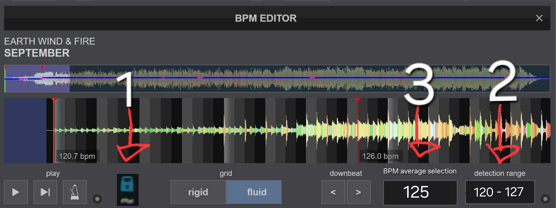

It locks at whatever the BPM is at the time you engage it, so if you lock when the BPM is 154 it will stabilize at 154 - the trouble is most of the BPM changes are invisible now. Unless it's a large change, neither the editor or the deck gives feedback to the user.
With the previous system, variations were visibile, so you could easily select an area, see the BPM and decide to lock at that tempo. Now the variations don't show and the track is made to look rigid.
See recent EWF example where the BPM shows a constant 126 for most of the track, when it actually increases gradually.
geposted Mon 06 Apr 26 @ 9:16 am

I'm making the request for the BPM variations to be shown, so that it's easy for users to see whether a track is varying or not, rather than hiding it from them and making it look rigid.
I'd compare the BPM readout to be more like a car speedometer than an oil gauge. It's the speed of the track. For mixing DJs it's one of the most essential things.
As I've said elsewhere, the vast majority of skins out there do not have the little tilde marker or the padlock on the decks (and may never get updated) so IMO it makes sense for the variations to be shown via the BPM readout.
Historically this was the way it was done with analogue BPM counters that "listened" to the music. The DJ could always see exactly what the BPM was at any time/any part of the track.
It's also an issue when it comes to knowing whether a track is being stabilized or not. In the earlier builds it was clearly visible because the BPM readout was steady. Now it's steady even when the track is varying.
I can learn to live with it if it's not reverted, and I can always use the earlier build to analyse instead, but I would prefer for the variations not to be hidden. Perhaps we could be given a choice? 👍
geposted Mon 06 Apr 26 @ 12:37 pm

I've not seen them displayed elsewhere - even in the editor, many tracks now just show one anchor, one BPM and a straight blue line. Yes there are sometimes red areas, but even if you zoom in on those areas, it doesn't always show you a BPM value there.
I had a track recently where I had to place anchors manually throughout, as the analysis couldn't understand it (Hugh Masekela - Grazing In The Grass) and if you do that, you get a readout when it passes the anchor - but surely the idea now is to avoid manually placing anchors?
geposted Mon 06 Apr 26 @ 1:02 pm
That's because the BPM doesn't really change. It's the phase changes that cause the red areas.
At least that's the case on the tracks I checked myself.
If you have any track that has a significant BPM change that's not displayed, feel free to share! :)
geposted Mon 06 Apr 26 @ 1:30 pm

When I DJ, I never mix two tracks with more than a 5 BPM difference. That’s why having the BPM variation clearly visible is important to me. If a track starts at 120 and gradually rises to 125, I need to know that in advance, because it directly impacts how I approach the mix.
That said, FLUID beatgrid is a real game changer and it’s already working incredibly well. I’m just sharing a few minor suggestions that could add further clarity and potentially benefit the wider community, not just my own workflow.
geposted Mon 06 Apr 26 @ 1:48 pm
All I wanted... is if a "lock" could be added to the BPM editor so that when we want to permanently lock the fluid... it's annoying to have to remember to press the lock all the time.
geposted Mon 06 Apr 26 @ 2:09 pm
