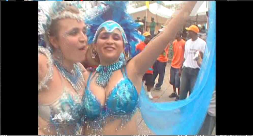

How can I fix this problem, some video's display full screen and some does not, included sample image.
Thanks, Joey
Thanks, Joey

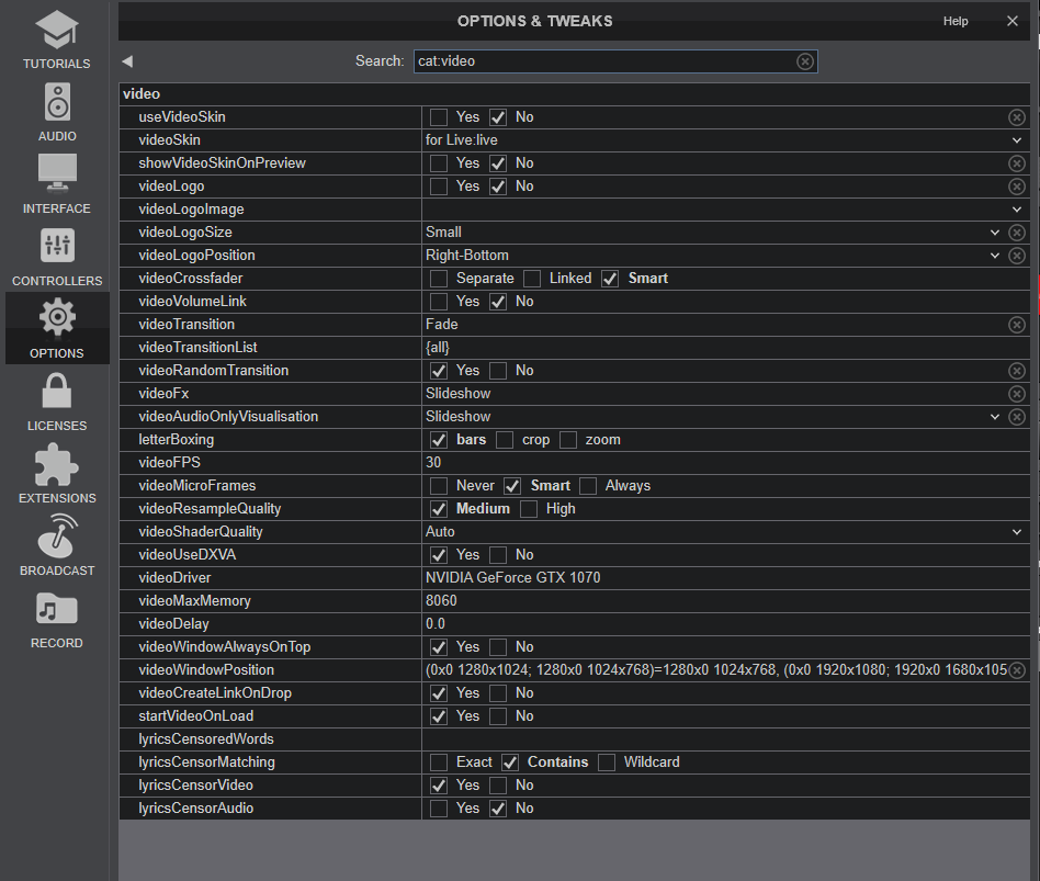

setting letterBoxing
but it's a bit of a muddled fix [and always will be], some vids will look ok zoomed, others ok when cropped, bars the image will always look right you could fill the edges with blur plugin.

I have new information on the videos that doesn't render full screen on external monitors,
The videos are 720x480 pixels MPEG Video.
My VDJ display settings are attached in image, if some of these can be changed to enable full screen display I would appreciate some help with this..

As locodog suggested, you could use the blur option. You could also zoom it (but lose part of the top/bottom).

After looking at the options in the video display as per above screen shot I found a setting for Video Window Position, it has a lot of video parameters already entered like these below,
(0x0 1280x1024; 1280x0 1024x768)=1280x0 1024x768, (0x0 1920x1080; 1920x0 1680x1050)=1920x0 1680x1050, (0x0 1920x1080)=1252x101 640x360, (0x0 1920x1080; 1920x0 3840x2160)=1920x0 3840x2160, (0x0 1920x1080; 1920x0 1680x1050; 3600x0 3840x2160)=1920x0 1680x1050, (0x0 1920x1080; 1920x0 1920x1080)=1920x0 1920x1080
Can I just enter the the video format I am missing in a particular way so it can work for 720x480 pixels at full display?
Thank you..
Thank you..

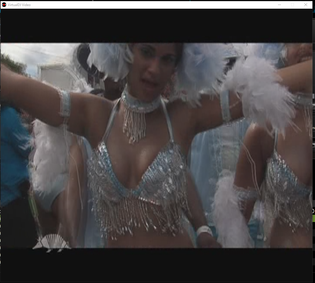

This is playing on the older version of VDJ full screen from left to right like in this example below,
I could stretch it on left or right and it doesn't create black ribbon like in current version.
Now on Image #2 is being play with the current version of VDJ.
I could stretch it on left or right and it doesn't create black ribbon like in current version.Now on Image #2 is being play with the current version of VDJ.
