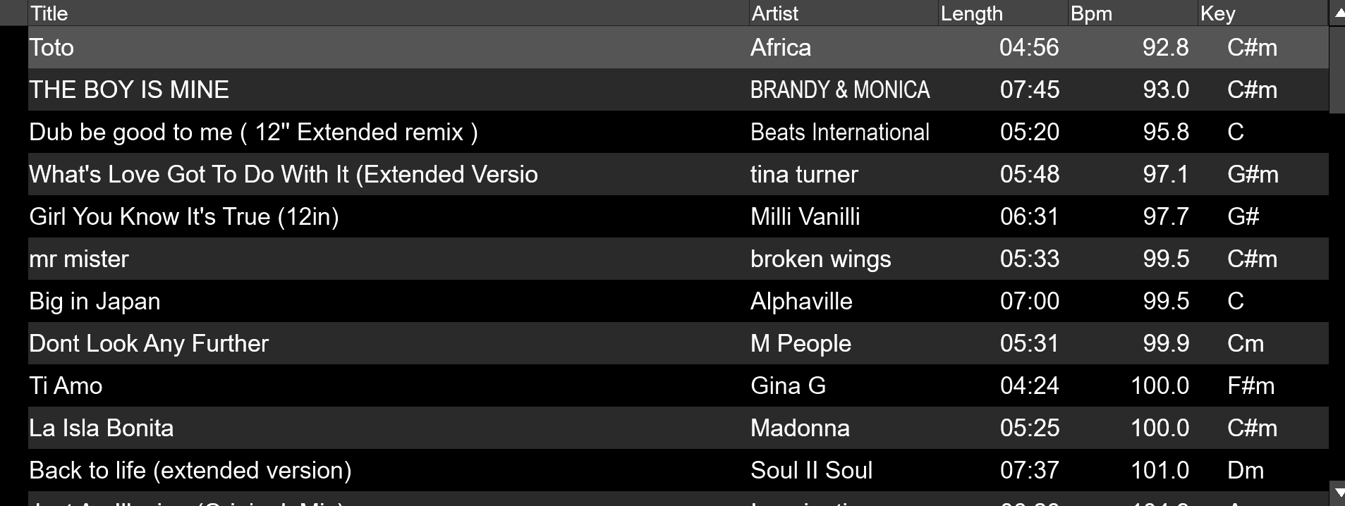

So i find a way to the browser with this:
Do you know a way to customize it? i mainly missing the "Played song" column
<filelist attachX="right" attachY="both" grid="no" visibility="true" >
<size width="1920" height="720"/>
<pos x="0" y="0"/>
<font name = "Arial" size = "30" weight = "normal" />
</filelist>
geposted Tue 03 Mar 26 @ 8:13 am
