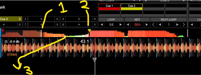

Hi i want to refine the songpos element a little more. I have a few questions about this and refering to the numbers in the attached pictures.
1) Can this slider be changed in thickness of color? (i want it a little whiter and more clear without
shade). If i use colorplayed="no" the area behind the if a little darker. What are the options with this
slider?
2) If have Cue markers in skins (for instance Vanced GT) that are using letters. How can i use these
for cuepoint? and how to place them a little above the waveform? The same question i have for the
original skin. This skin is using are triangle and cue number xxx as marker. I can`t find this in the
XML file.
3) Could also a slider be used under the waveform to see where you are in the waveform?
4) I have seen attribute waveform="yes" in songpos, but can`t find out what it does.
gr. Marcel

1: As far as I know, you can't change the thickness of that “slider”; it works more like a progress bar. You can change the “colorPlayed” color.
2: The cue marks in songpos don’t allow text inside or next to them like in the waveforms (it would be great if they did). I use two overlaid sliders with a square shape and another with the cue ID as the element. Similarly, with the other cues, they all use cue_pos X, but it doesn’t look the same on Mac and Windows, which is why there’s a “define” for each system.
3: Yes, you can use a slider with the “song_pos” action for that.
4: I’ve seen that too, but there’s no documentation on what it does, and when I tested it, I couldn’t tell if it did anything, so who knows.

Hi, thnx for your reaction.
I have a hard time to get this part working..... whether it is with or without your text based cue labels.
When i am coping a part (below) a script (cues) i tought the cues had to show up, but don`t.
<cues colored="yes" shade="0.1" shadesize="2" dy="0">
<size width="12" height="13"/>
<up x="66" y="220"/>
<down x="66" y="220"/>
<over x="66" y="220"/>
</cues>
Do these cuemarkers always have to work with the clipmask function i.c.w. the png file? And if so like the orignal VDJ PRO skin, i can`t scale them up.
I tought only these part (cues) as child of the songpos element is used to project the cue labels
on your waveform.

Yes, you're missing the “clipmask”; that will give it the shape of your cue markers. And yes, just like the simple icons, they don't maintain their quality at high resolutions.

Its not easy to find the relationsship with the elements together to form a text based cue label.
I have found the following code in your skin script;
Could you explain me a little more how these things related to eachother?
<define class="songpos" placeholders="*width,*height,*half">
<songpos colorPlayed="played" colorBass="colorlow" colorMed="colormid" colorHigh="colorhigh" half="[HALF]" colorvocal="colorVocal" colorinstru="colorInstru" colorbeat="colorBeat" colornobeat="infobackcol">

It's a custom “songpos,” so I just have to adjust its horizontal and vertical size when I use it in other layouts of the skin, without having to worry about resizing each element again.
The first one is the original element but without cue marks.
Next is a slider that tracks the song’s progress with a more visible line—I think like what you mentioned earlier.
Further down is the “define” for custom cues with numbers/letters (for PC).
And finally, the 16 sliders that use that “define” to display custom cues on the songpos.

You'll also notice that sometimes the positions are a bit odd, like x="-10+11"
But that’s because I didn’t have a separate “define” for Mac and Windows before; there was just one that was tested on Windows.
So, to avoid losing something that was already working well, I just kept adjusting the position until it looked right, and if I couldn’t fix it, I could always delete what I added and leave it as it was.
That’s why it seems a bit illogical to set x="-10+11" when I could have just set x="+1"; they’re simply records of how the position adjustment has changed as the skin and other elements are updated.
