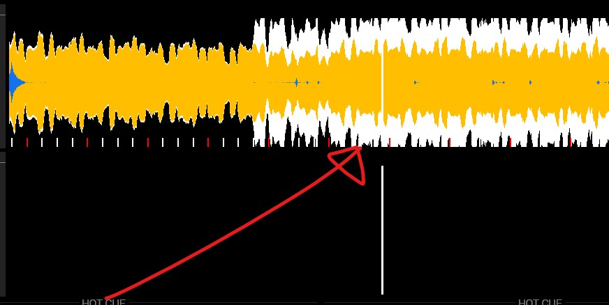

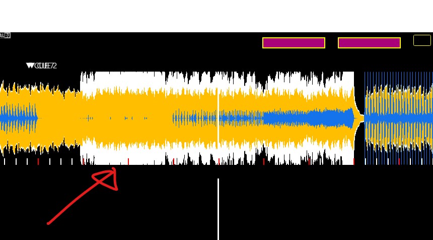

I like the waveform shapes vieuw, but the shapes are bigger than the scratchwave outer window.
I have this with and without stems analyzed. (mainly these are the instrumentals)
Could this be a setting?

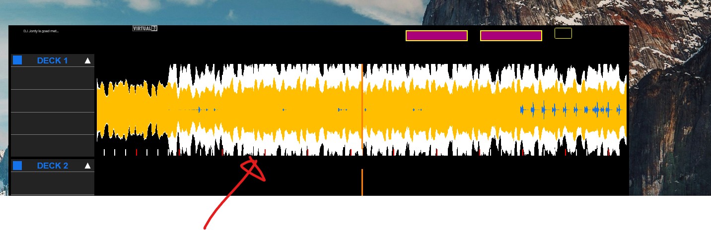

It`s my "own" skin design written;
This is the code;
This is the code;
<define class="Waveform">
<!--Square line only set on to visualize the border of waveform-->
<square border="2" border_color="yellow" visibility="no">
<pos x="+0" y="+0"/>
<size width="2135" height="415"/>
</square>
<square color="black" width="2135" height="415">
</square>
<scratchwave orientation="horizontal" colorNoVocal="green" colorNoInstru="red" colorNoBeat="purple" colorInstru="#FFBF00" colorVocal="#ffffff" colorBeat="#1473eb">
<pos x="+0" y="+45" width="2135" height="370"/>
<cue x="0" y="-20" height="25">
<text dx="-12" dy="-25" weight="normal" fontsize="30" Font="robot"/>
</cue>
<grid mainsize="3" phrasesize="3" size="4" height="25" pos="0" maincolor="red" color="white" transparency="1" mirrored="yes" background="no"/>
<gridlines width="0.1" color="white" transparency="0.1" visibility="no"/>
<overlay>
<pos x="+1067" y="+0"/>
<size width="6" height="370"/>
<background color="white" shape="square"/>
</overlay>
</scratchwave>
</define>

I don't really see any real issue. Most likely it looks wrong because your grid is inside the waveform area instead of below it.
So what you should really do is to move the grid.
