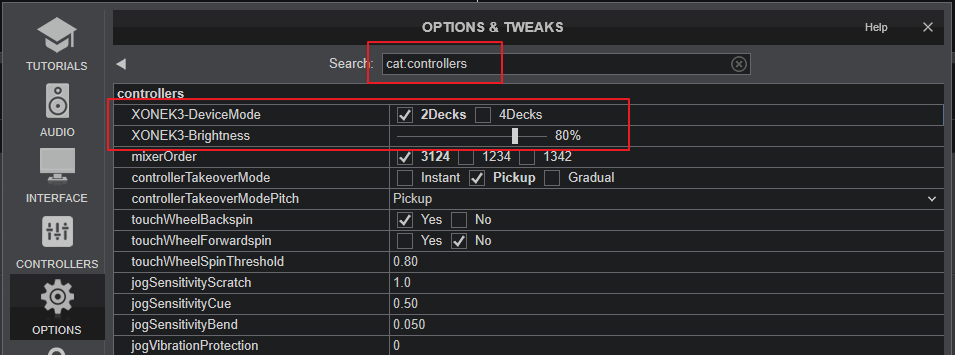

With the Xone K3 connected to USB, open VirtualDJ Settings -> OPTIONS tab ->Controller sub-category and select your preferred operation for your device.
  • XONEK3-DeviceMode : Select if your K3 will operate in 2-Decks or in 4-Decks mode.
  • XONEK3-Brightness : Adjust the brightness level of the RGB leds of the Xone K3.

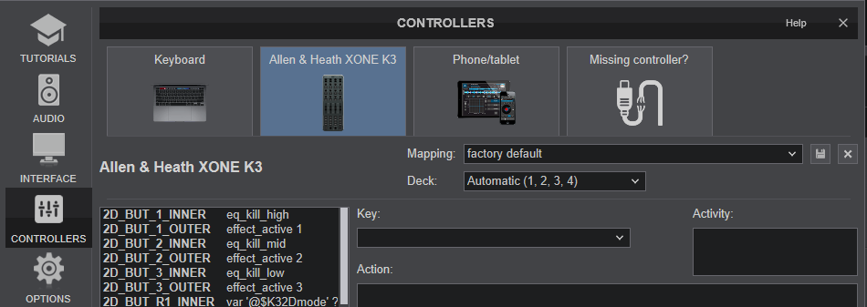

The Xone K3 should be visible in the CONTROLLERS tab of VirtualDJ Settings and the “factory default” available/selected from the Mappings drop-down list.
Find more details at https://www.virtualdj.com/wiki/VDJ8script.html
Note : There are 2 kind of MIDI keys offered in factory Mapping, named as 2D_ and 4D_ (stand for 2 Decks and 4 Decks modes as selected from the Controller settings above) If you need to assign a key with an action and keep this along both modes, you will need to assign the 2D_ and 4D_ keys as well.
